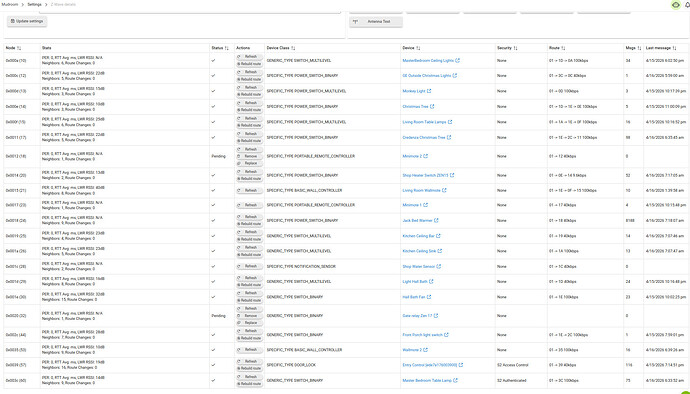

Zwave has been very stable over the years. Recently, lights are sluggishly are not at all turning on or off. I am thinking Zwave ghosts. I have not added any devices for some time. I have shutdown hub, removed power for 15 minutes and rebooted, no change. here is my zwave details. How can I find out which is polluting the zwave network: 2.4.4.156
I'd start with the devices that say pending.
I'd say the battery sensors wouldn't slow the mesh down.
How about that ZEN17 Gate relay? Get that working. Maybe some other stuff out there is routing through it.
