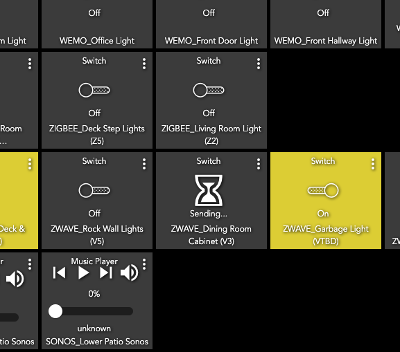

My Zwave devices when I turn on and off respond quickly. But the dashboard and the status of the device are very slow to update. I've tried changing the preferences but it doesn't seem to matter. Is there a way to adjust this? It seems to stay in this "sending" mode until I refresh the dashboard.

I am moving devices over from ST and so it’s possible I did something wrong although the device is acting right and turn on and off quickly. The only issue is the dashboard not showing the correct state.

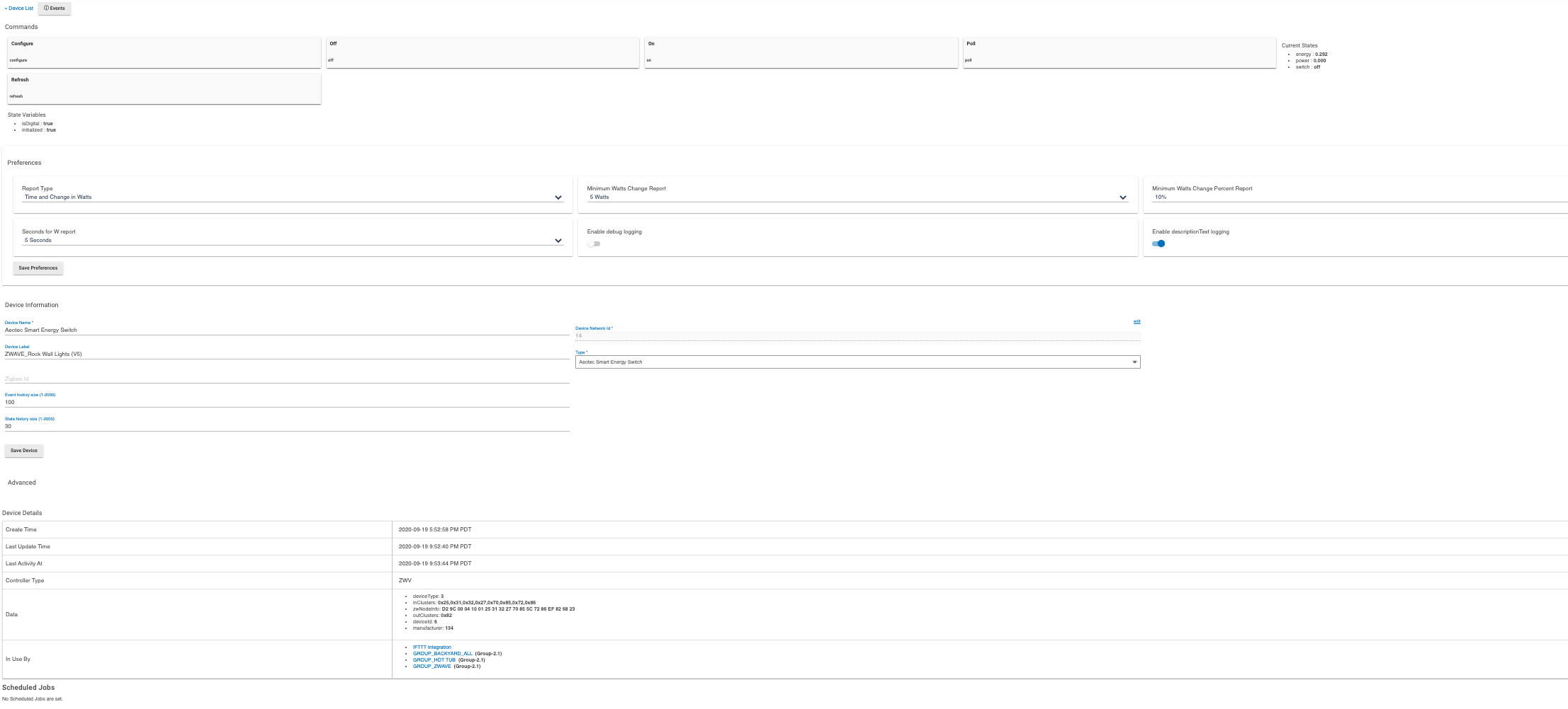

@neonturbo The switches that are killing me are Aeotec Smart Energy Switches. Unfortunately I have these for most of the lighting in my backyard and they are currently super hard to turn on and off via the dashboard. I had them all working pretty well with ST and I've got them in the same place and Hubitat in the same place. It took me a while to get the mesh working well in ST so I tried to keep it all the same.

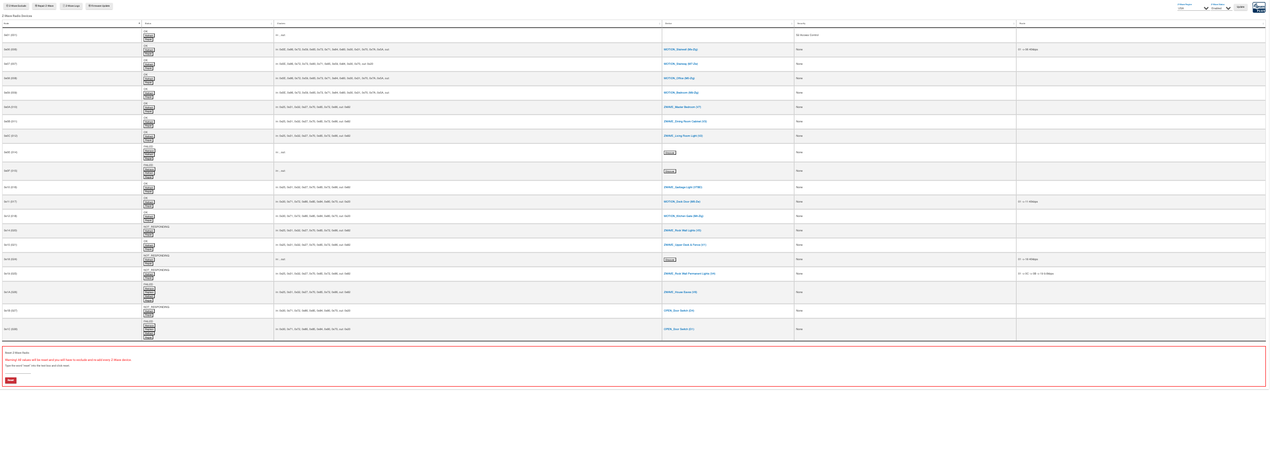

It looks like my network is jacked up with a bunch of rogue entries. Not sure how to delete those as I've tried to remove them and run multiple Zwave network repairs.

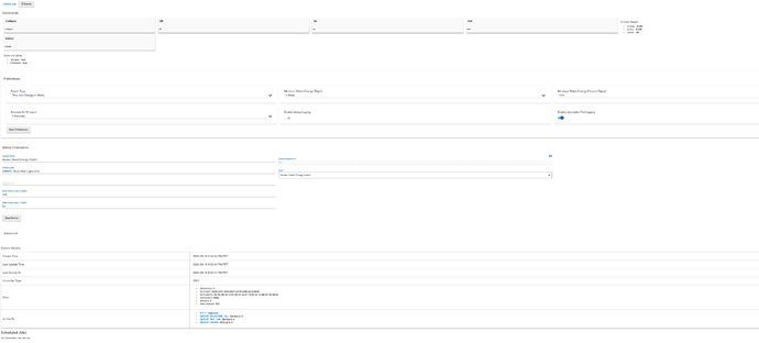

You will want to change that power reporting. That is killing you. You are sending TONS of power reports. You do not want to set to 5W AND 10% AND every few seconds, that sends dozens if not hundreds of power reports, which is overwhelming your hub.
You DO want to pick one or maybe two of those 3 reports to use. And then tweak the ones you do use up as far as you can and still get reports.
What are these power reporting devices watching? Things like wash machines 5W setting would be ridiculous as most draw in the hundreds of watts when running. A bulb or something, that might be appropriate.
Thanks @neonturbo. I disabled all of those wattage reports since although it’s interesting it’s only something I look at occasionally. These switches have strings of lights on them and I only really care about the wattage when I’m adding strings or trying to reduce usage by replacing a set with LEDs.
Any idea on how to get rid of those un-identified entries? I’ve tried removing/repairing/discovery/zwave network repairs but can’t drop.
Most seemed to disappear with the nightly cleanup but there is still one:
0x01 (001) OK in: , out: S2 Access Control
If it is what I think this is, you don't want to remove it.
In a C7, the first (from memory) 5 entries are the hub itself.
