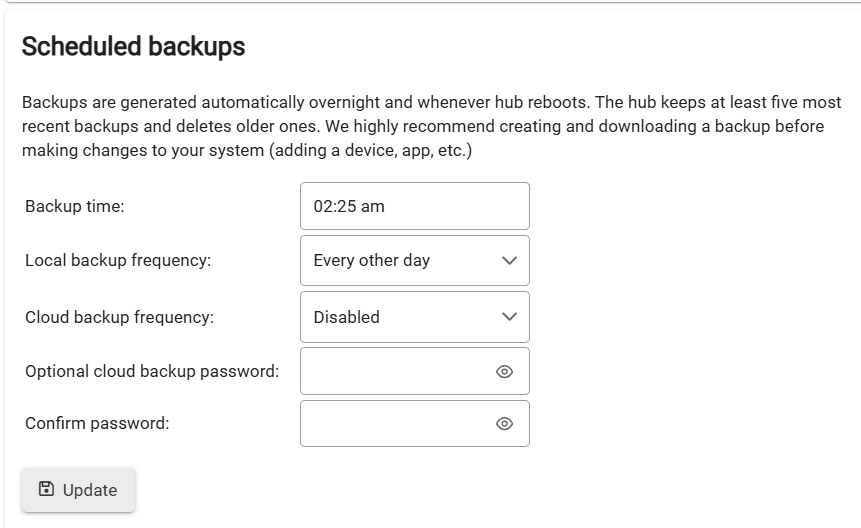

Is it possible you have set a nightly backup for around the same time you are trying to control your devices? Settings>Backup and Restore:

Thanks for the response. No backups scheduled.
