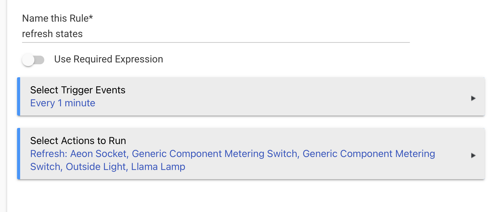

As a work around, i created a simple "refresh states" on an interval schedule, which should work for any device.
You determine how often the state is "polled" or refreshed.

That being said, a rule would certainly work too and gives you more flexibility, aside from the "backing down" the Poller app is supposed to do if there are problems.
