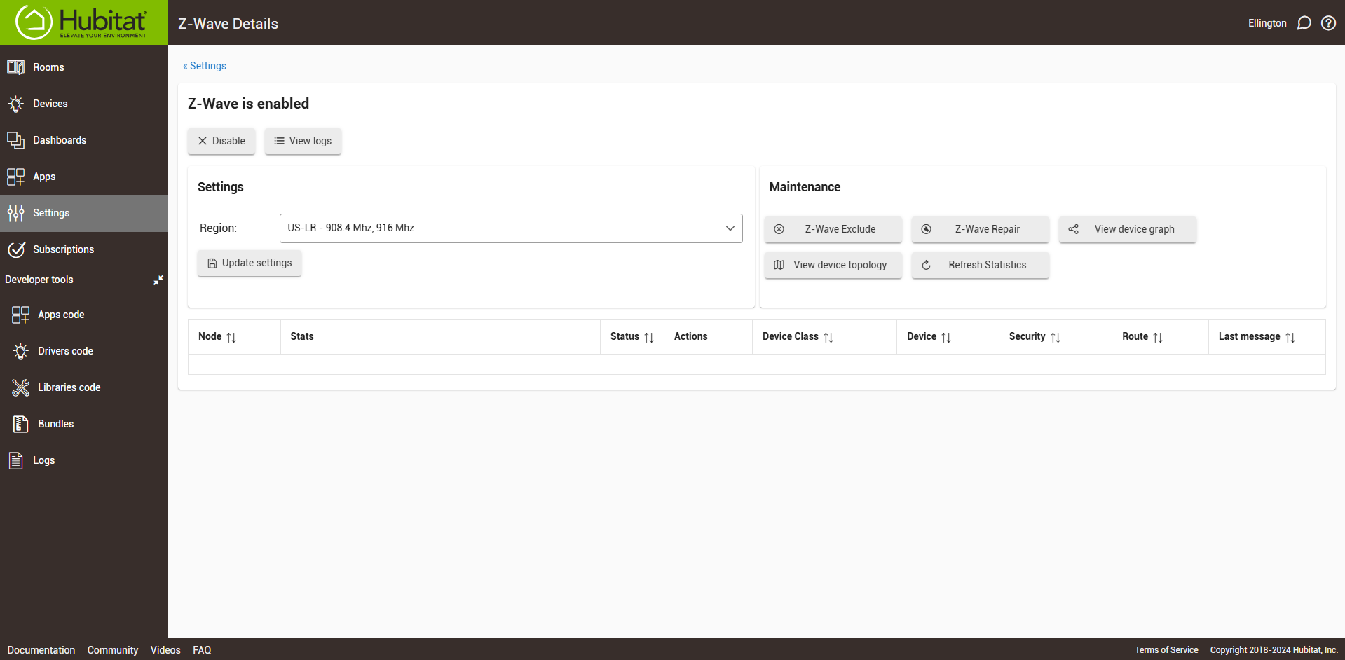

Can you post your z-wave details page in its entirety?
Here you go!

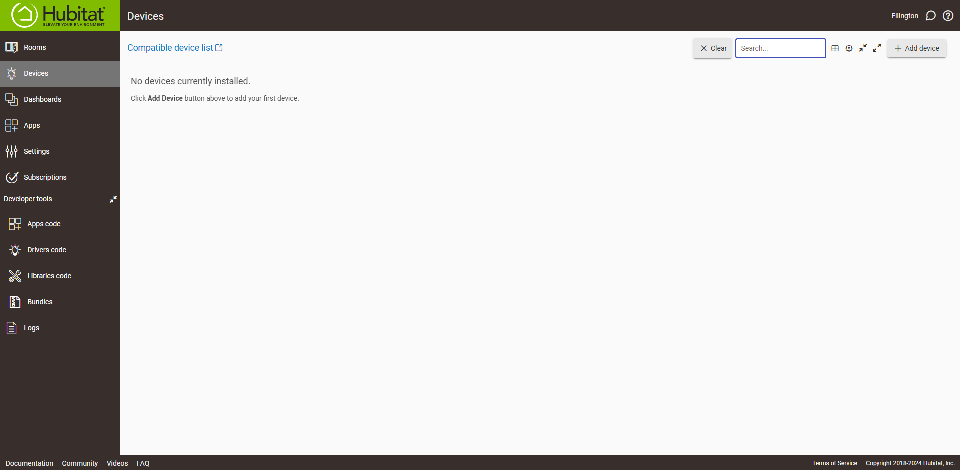

are there any z-wave devices under the devices tab?
No, because I cannot add and I did a reset on the unit.
I was just making sure none were present under the device tab itself
No. Completely empty.
