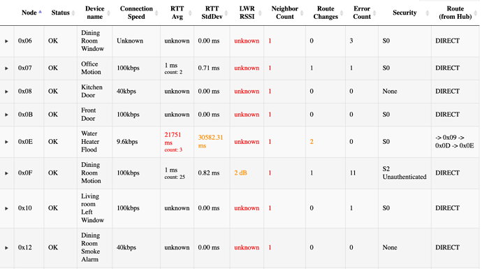

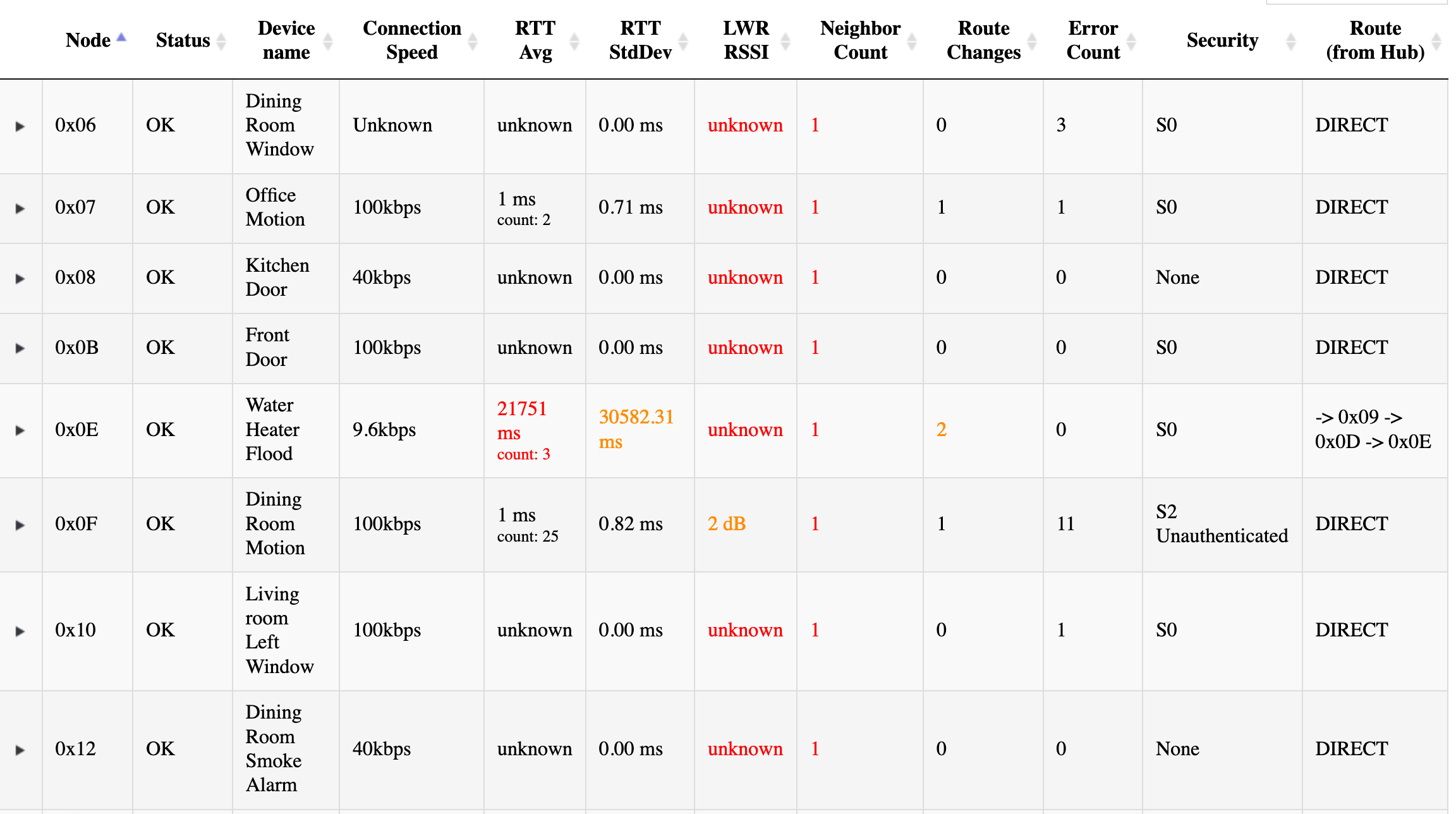

This is the network now with no repeaters (waiting until some of the new devices show up to re-added everything back in)
