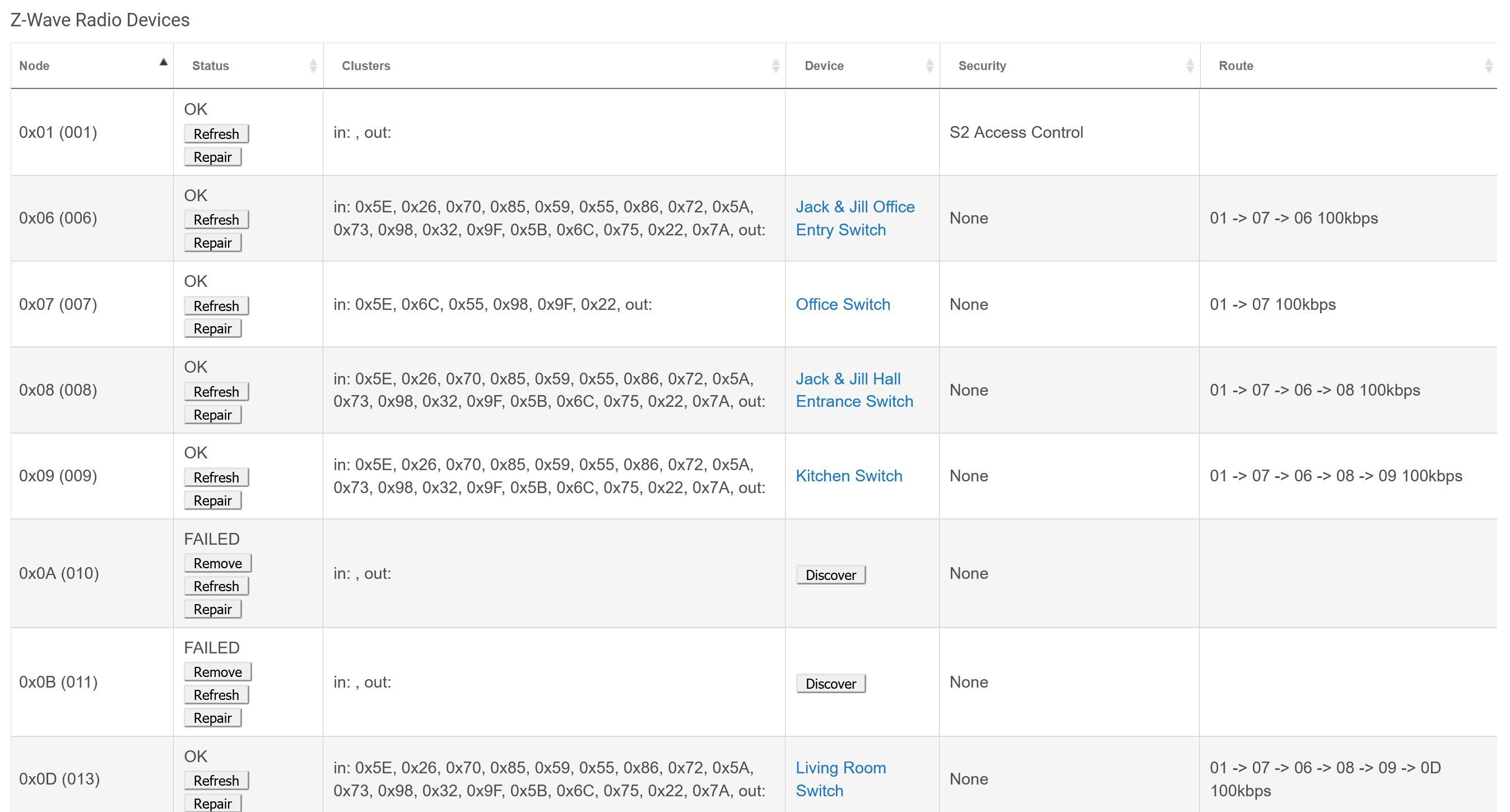

Trying to include innovelli z wave switches, however they just won't pair. No matter what i try.
i am thinking maybe i have some sort of bottleneck that's not allowing more devices to connect as it maxed it's through connections.
Anyones thoughts will be greatly helpful!
The first thing of note is that you have 2 ghost devices. 0A & 0B.
Secondly, have you tried a shutdown via the menus then a power down, wait 1 minute then power back up again.
This will ensure the z-wave radio reboots.
It won't get rid of the ghost devices but it may allow you to start pairing z-wave devices again.

basic rule! Always restart. Thanks it worked
Glad it worked.
It# think the power down was the important thing.
Apparently there is a nightly routine which will try and get rid of ghost devices.
Some people have reported that it does not work.
Who knows!!!!
If your z-wave devices are working OK, then personally, I wouldn't worry to much.
If you don't get rid of those ghost nodes it will break again just fyi.
