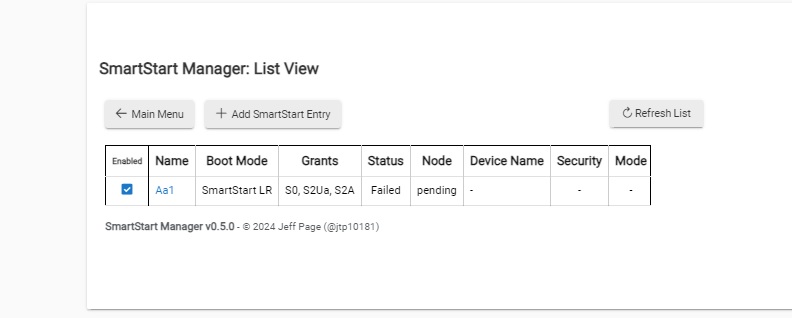

I'm trying to add the Homeseer Door/Window sensor to a Hubitat C8pro. I tried mutiple times to get the sensor to work using the LR option. If I add it as a normal zwave it works fine. Most of the failed LR adds resulted in mutiple entries in the zwave details page. I shutdown the hub and waited over a couple of mins before restarting. This time I have mutiple zwave entries and the last entry has a device associated with it. It connected as a "Jasco PRO plugin smart switch". Changed the device type to Device and when I did anything to the sensor nothing was shown. Checked the Smart Start Manager app and it shows the add as a fail.

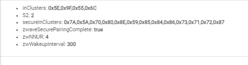

Here are some of the logs and information.
device

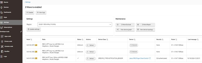

Is that last node in your table (0x0167) this device? If so, it appears to have been successfully added as an LR device. I would leave the the third-party app out of the picture for the moment since the Z-Wave Details table is the authoritative source, but it pulls the same data, just not in real time, so it should be accurate too (reloading the main page of the app or hitting "Refresh List" may help).
For the two nodes above this, assuming they are non-functional, you should be able to remote them, either from a Remove button that might appear in a few hours or by selecting "Refresh," waiting a few seconds for that to complete, then seeing if "Remove" is there (and maybe trying once more if not; do not go too fast, do more than one operation at a time, or do anything that might test the patience Z-Wave is known for requiring).

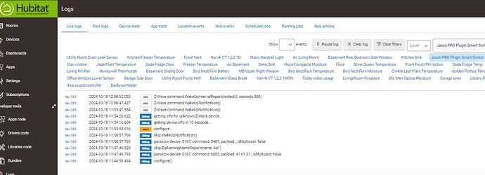

Do you see anything in Logs with the debug logging option enabled? That would help tell the difference between a problem with the device (it sent something in your logs above) versus one with just the driver (not parsing the information correctly, though this seems unlikely nowadays...).

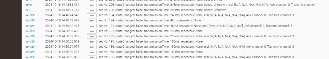

With Debug logging on nothing happens when contact is exercised. When I look at the Z-Wave Details the last message is from several hours ago. The Z-Wave logs have these entries:
This suggests that the driver isn't receiving anything from the device (as opposed to it just being a driver problem), which, while maybe not surprising, is good to know for troubleshooting.
These only show commands sent from the hub and are rarely helpful for troubleshooting problems with a device, if anything at all.

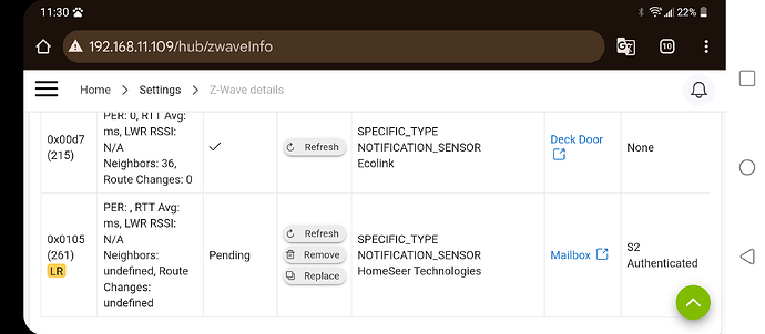

It.paired but not fully nor correctly
There were no logs generated during pairing. See how zwave info says pending and no stats. And the smartstart app entry says node pending status failed? See attachments
I rebooted. Nothing works no attributes etc. No zwave events or messages

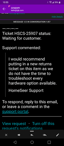

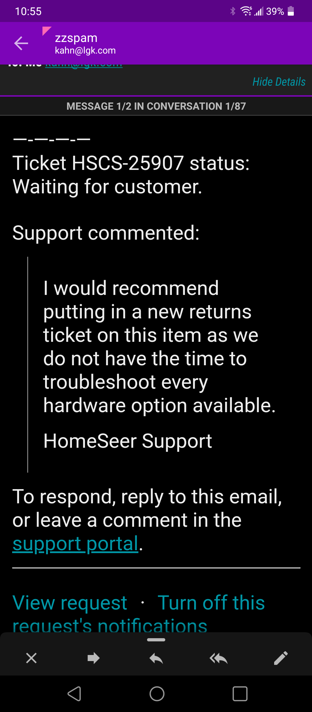

I emailed homeseer support
. Useless they say contact hubitat and are unwilling to debug or test. When i complained.. they said send back for a credit.

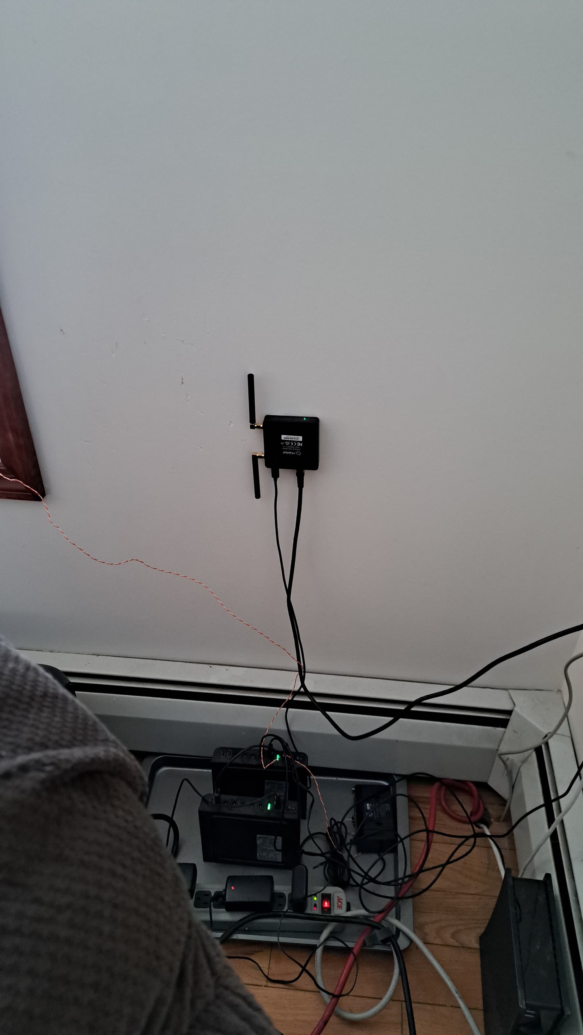

Maybe where i mounted the hub helps:
