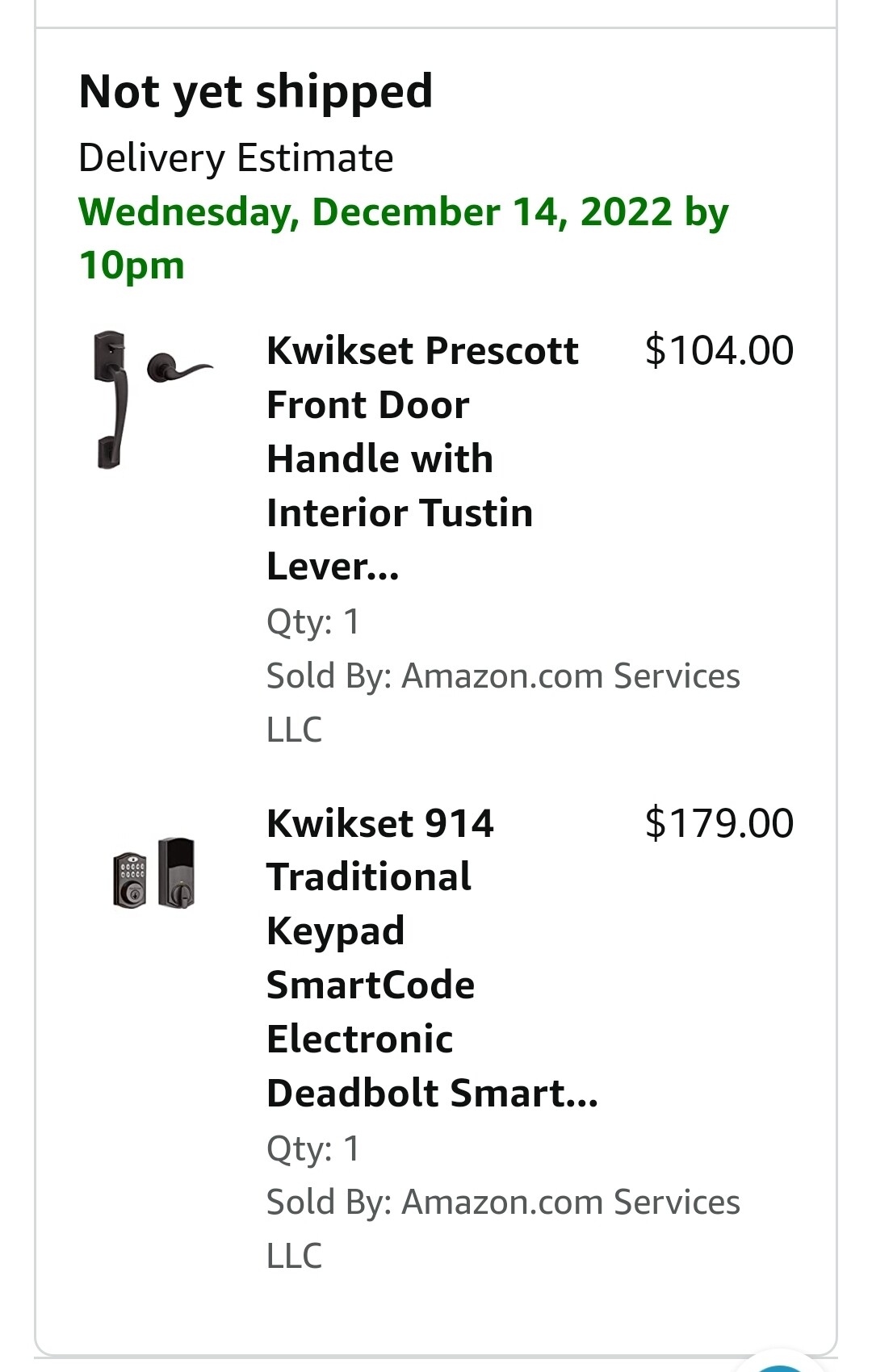

Just ordered a kwikset 914 should be here Wednesday.

Awesome! I'm kinda excited to get mine Wednesday.
