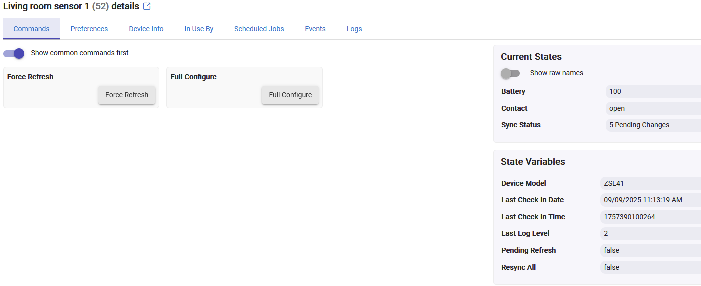

After switching the zse41 driver the device says there are 5 pending changes that will happen the next time the device wakes. I pressed the button 4x on the device to force the check in. Device blue light blinks, but it still says 5 pending changes even after waiting a few days.

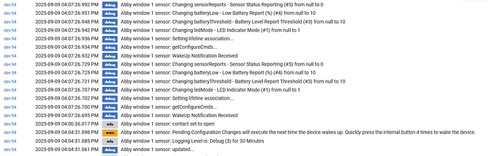

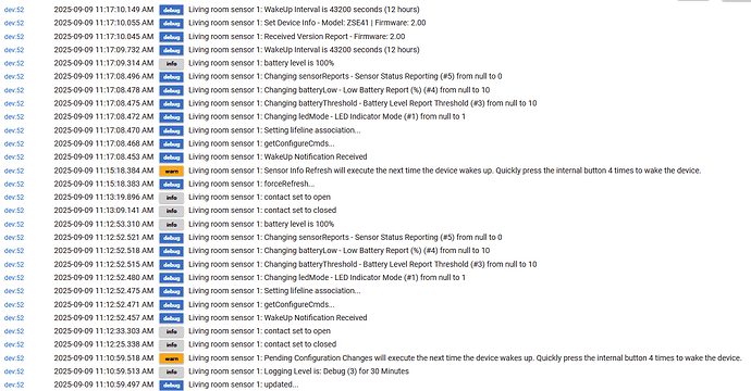

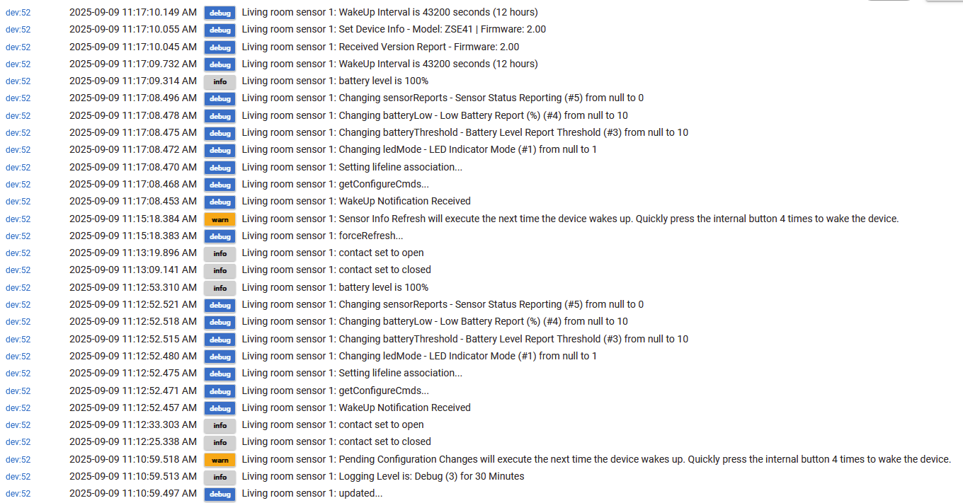

Here's what I did -
  1. debug logging = on
  2. closed window
  3. opened window
  4. woke zse41 up (button 4x)
  5. closed window
  6. opened window
  7. tried "force refresh" button on device screen
  8. woke it up again
  9. screen shots (note: 5 pending changes still there)
I am not seeing any response to the various Get requests the driver is sending. The only things coming through are its own pushed events.
