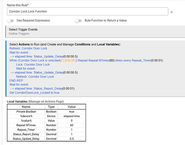

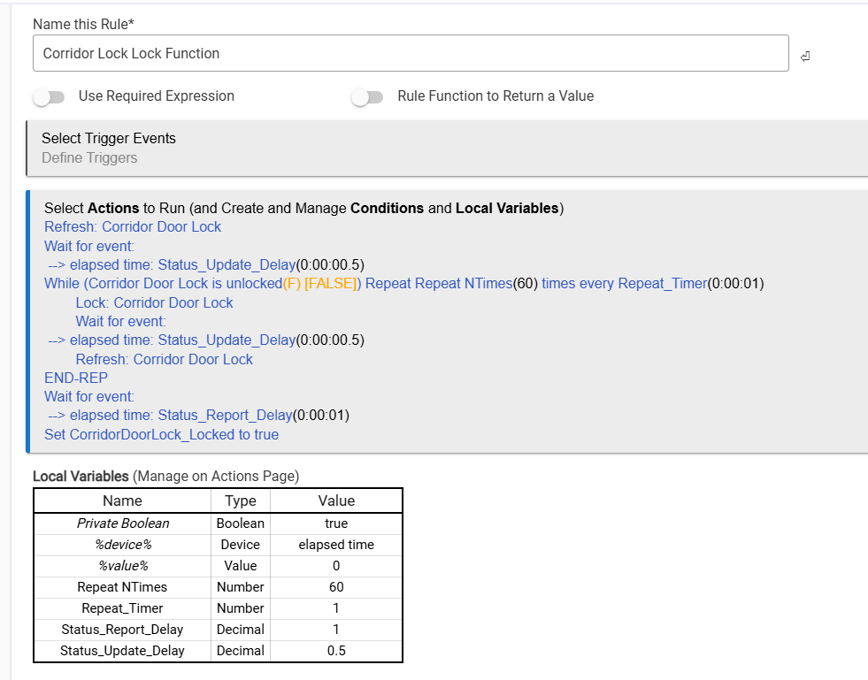

Many users are very happy with ZWaveJS. I decided to cleanup a bit the ZWave Mesh and to try again ZWaveJS. The cleanup was done after the switch (maybe it was better to cleanup mesh first). Of course, the random delays instanly started to pop up. For the Ultraloq Lock I had to create a lock/unlock function rules which are called from the main rules instead of a simple commands. For some reasom Ultraloq Lock almost never report an updated status but doing a "refresh" helps a lot. Here one of the function rm rule:
