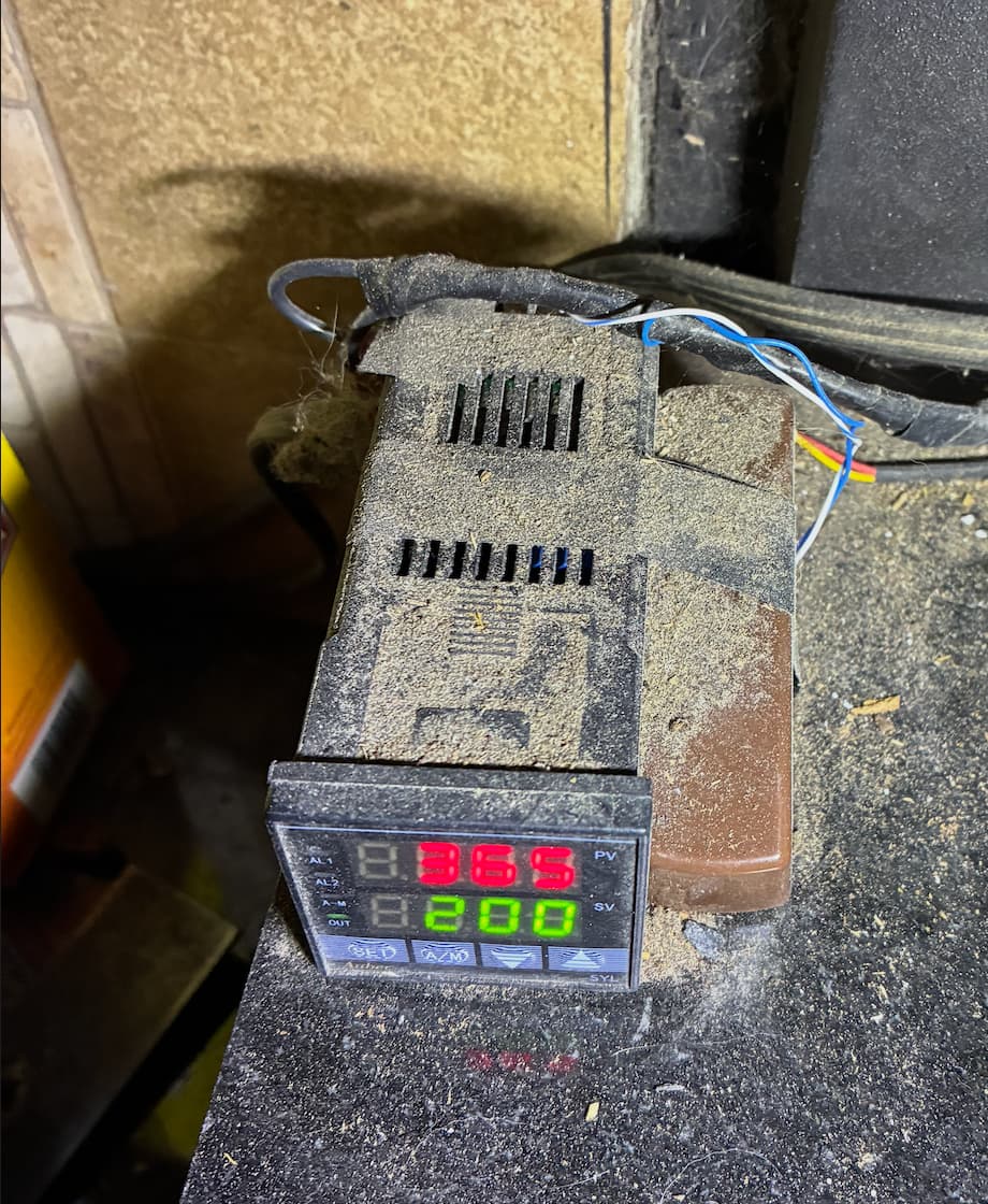

Excuse the dust. It's attached to a temp control at the wood stove. Comes with white and brown covers.

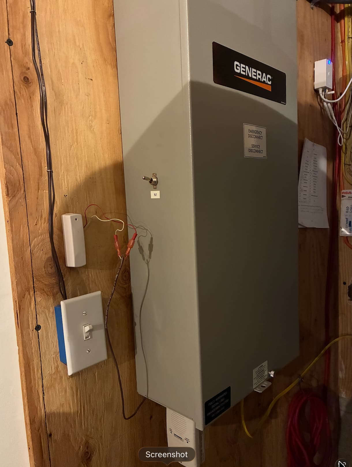

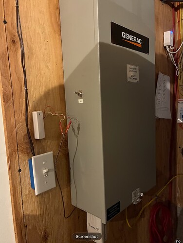

Transfer switch status to Hubitat:
