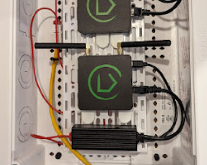

Recently, in a fit of what i considered cleverness, I installed a new in wall structured wiring box of diminutive size, in a dead space in the wall at the top of my basement stairwell.
The box is about 9 x 16 by abot 3.5" deep, and is WiFi transparent.
With a little planning, i squeezed a Ubiquiti Flex switch for PoE & network, and one of my new C8 hubs with a nice PoE adapter.
The C8 performs brillianly in this location, with a single hop to all Zwave devices in my house, as its roughly centered in all directions in the house, and has minimal obstructions interms of ducting or major appliances.
So far so good.
Eying the space, I realized I could use the free space to install a C7 to use for apps, all radios off, and retire my C5.
Installed perfectly.

Here's a picture of how great it looked while failing miserably :slight_smile:
Google Photos
S.
Man...gotta admit, that is damn pretty, really nice. Bummer that you couldn't leave them together. Nice work by you, regardless. You can come over and re-organize the in-wall wiring boxes in my house any time. :slight_smile:
Just noticed...unless the picture is rotated incorrectly, your antennas are pointing left-right instead of up-down. Working OK in that orientation, or just a pic issue?
