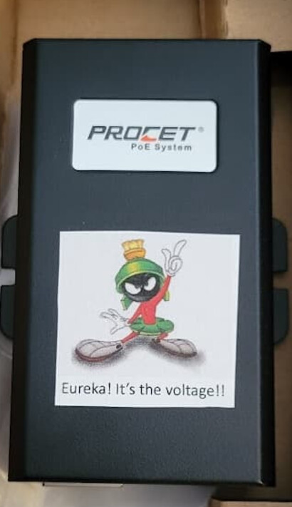

@danabw @dennypage so I got two of the "PT-PTC-AT" units today i put one on the C8 and its working thus far drawing very little power with 15.4 reserved
Actual consumption
Measured at the port: 1.7
Maximum Power drawn by the device since powered on: 2.9
