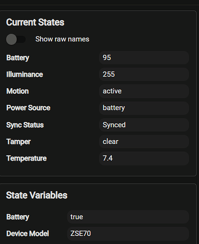

ZSE70 not releasing from Active
@jtp10181
Since you're the most knowledgeable :wink:
This motion has decided to stay active but I see nothing wrong.
I can Init and the status goes from Syncing to Synced fine.
Battery isn't that old and the lux is below the trigger level; haven't changed any Prefs.
No msgs or route on the ZW detail screen now.
It's p1ssing rain otherwise I would go out and hit the reset button. :wink:
I'll reboot it tomorrow in the daylight, just thought I would ask.
