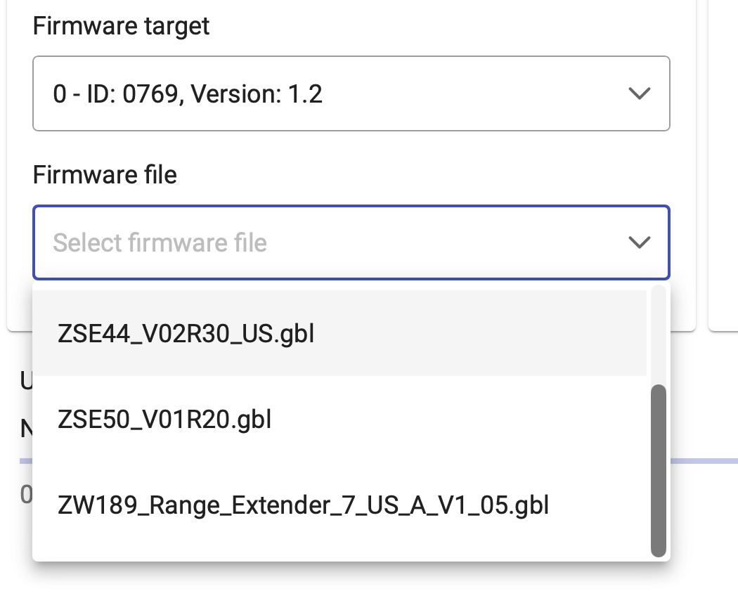

I noticed that there is a 1.3 version, but I am unable to install it. After copying if to the hub and select Device firmware updater and then the ZSE50, the only option is V 1.20 and it can’t fing the v 1.3 file.

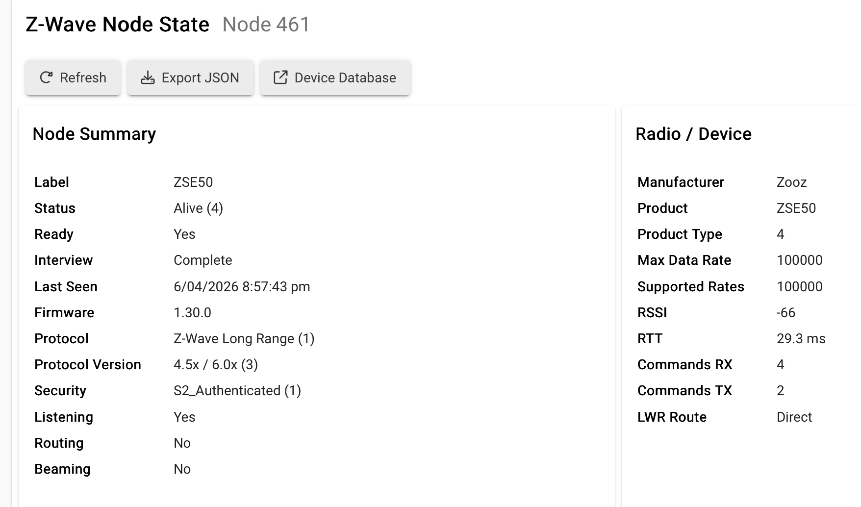

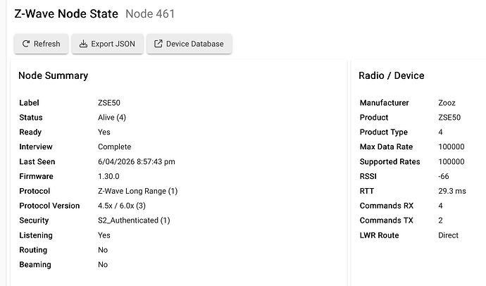

I was able to update to 1.30 which, of course, screwed up a few of the file numbers AGAIN! You have to choose the file to upgrade too…1.30 in your case, then upload it. The select the device: ZSE50. Choose the target: 1.20. The select the upgrade file: 1.30. It takes quite a while to upload to the device.

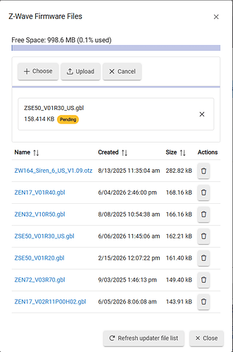

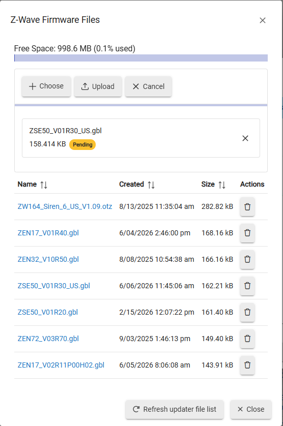

Here is the file in File Manager.

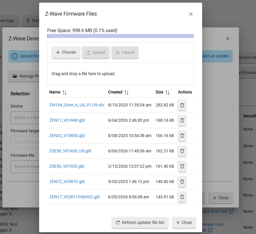

And here are the files that I can see. 1.3 isn’t listed. 1.2 doesn’t exist on the hub and selecting it shows Not Found.
First use Manage firmware files and you get the +Choose option.
You find the 1.30 firmware on your device
And the it shows this….

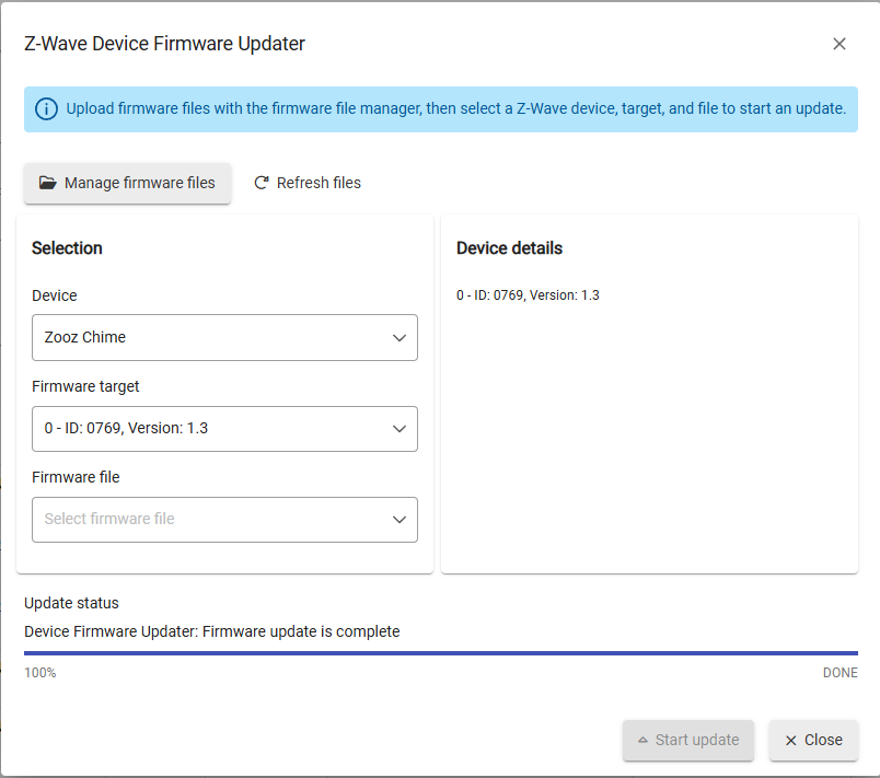

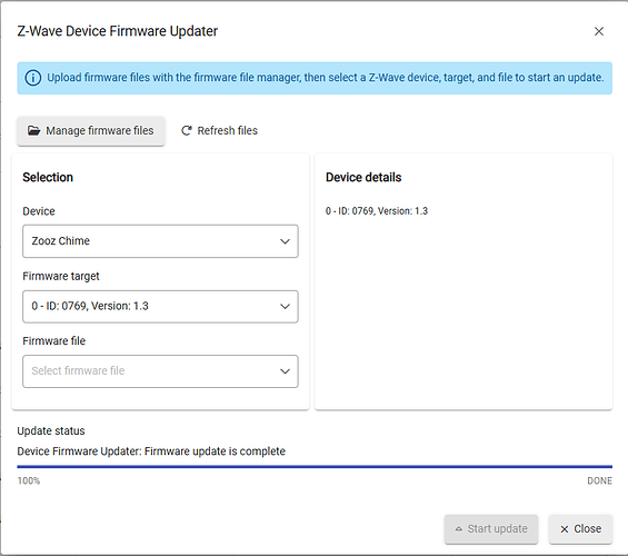

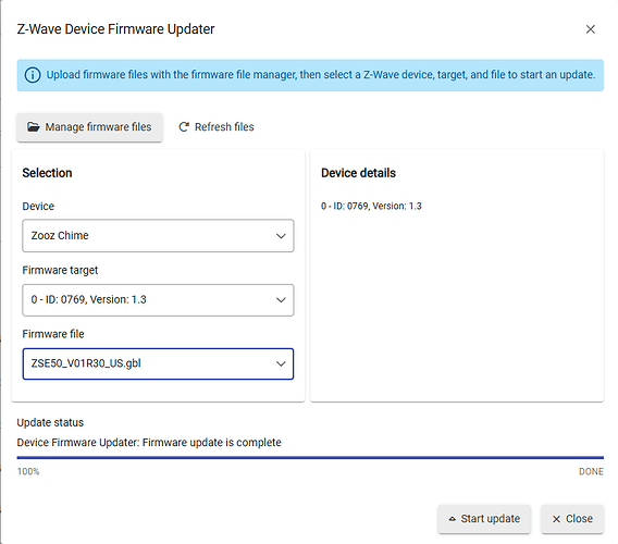

Where you click Upload. Then you choose the Device (Zooz Chime in my case) and it will show the current version if the device is online. As you can see, mine is already at 1.3, but yours will show 1.2 if it’s at that version.

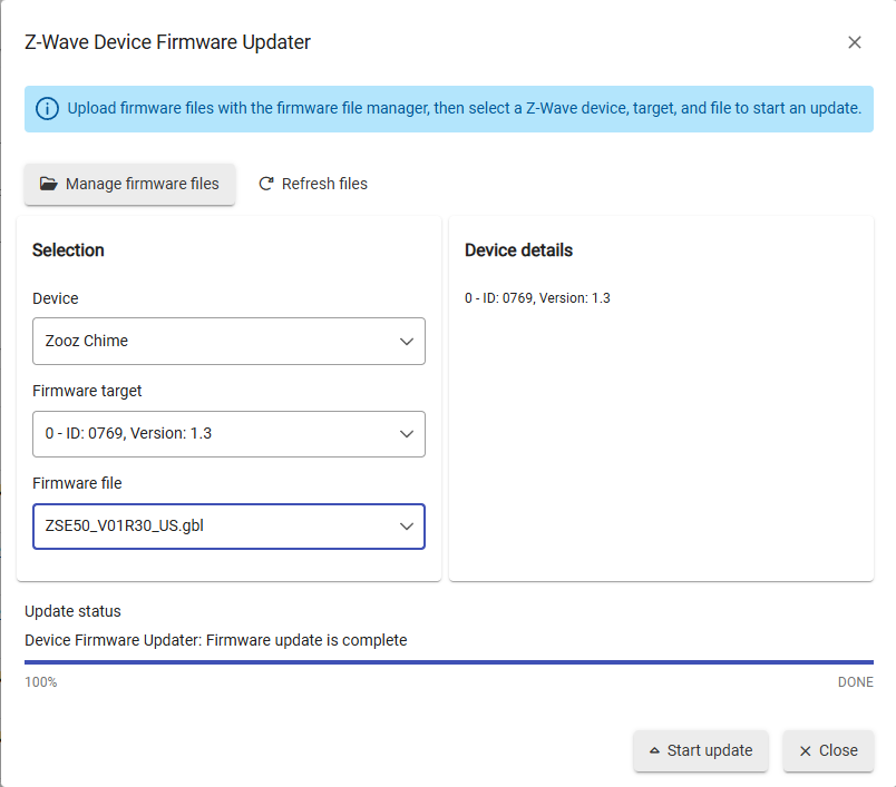

Then you should find 1.3 in the drop down list.
Excellent description of the process, thanks. I was doing those steps exactly. I guess 10th time was the charm, as it finally showed the 1.3 firmware file. Strange, that was.

I think I forgot that once you upload you need to hit Refresh files or the newly upload firmware may not show up as available in the dropdown list.
