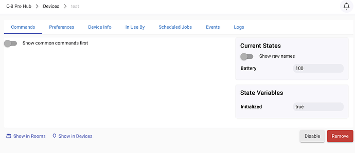

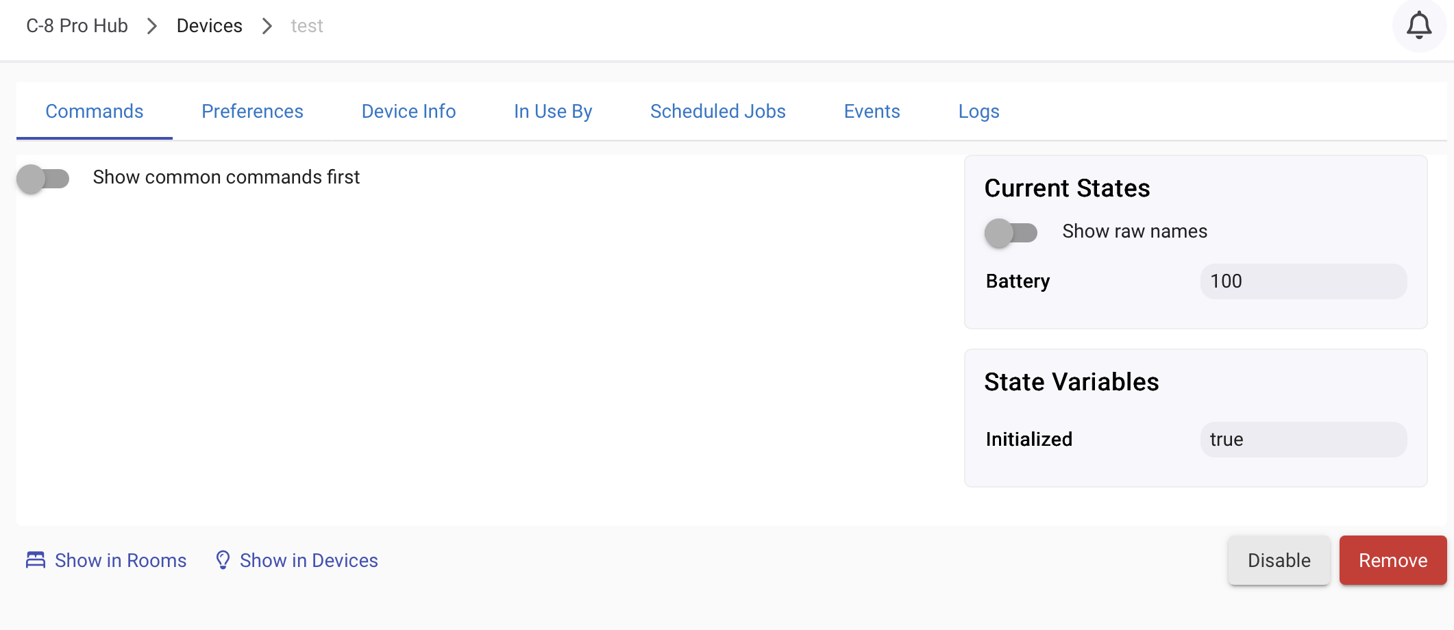

Dumb question (so forgive me) Did you click refresh on the device's page?
good luck with that
Thought it had a refresh button
No Most battery devices is going to will not respond to an on-demand Refresh or Configuration command without first waking it up.
Not totally true. My iblinds and several of my sensors do...
Probably want to check the log, if he's getting that 22% number off the device page.
ZWave sleepy devices do not respond ever, unless they are by chance awake (usually for ~30 seconds every 12 hours). So to avoid confusion Hubitat removed the refresh ability from most/all those zwave drivers. I usually include an alternate refresh command in my drivers which also then shows warning text that you have to manually wake the device up.
