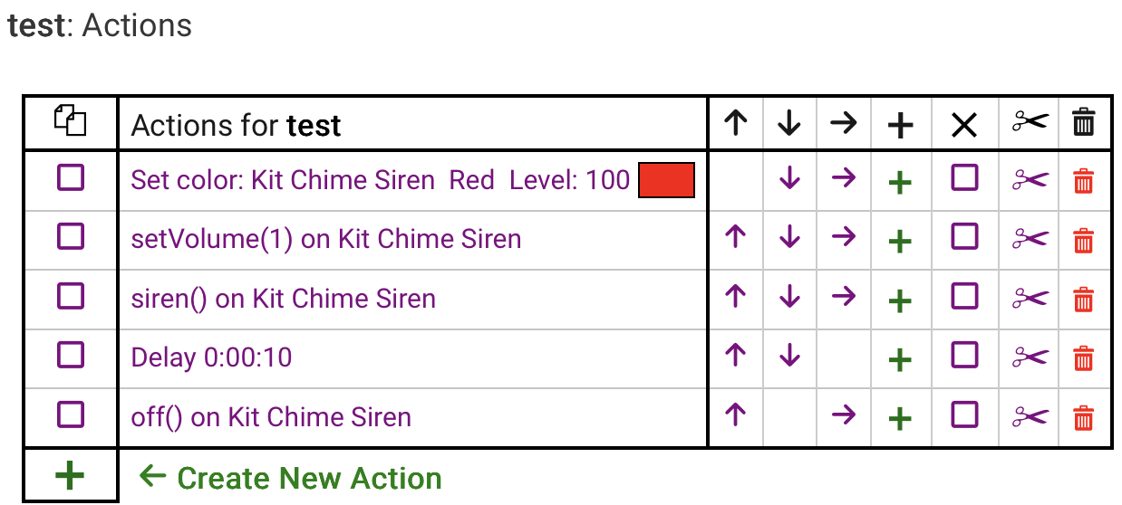

This worked for me just now. Of course I'll have to figure out how to get my smoke detector alarm working again, lol.
It used the set dimmer and bulbs action to set the color. A custom command for power source changed the volume to one, inaudible. Then a custom command for siren , a delay of 10 seconds, and then a custom command for off.

Like the color you see with the "Strobe" command? If so, that's just how the device works -- that color is whatever Zooz chose. The color you can choose affects the color you see for sound commands, which is why it works for "Siren" (and by default the device also does the light with sounds) in the example rule above.
@bertabcd1234 I’ve accepted the “strobe” will be green. However I’ve not figured out to turn on the strobe without having a sound. My goal is to use the strobe to indicate an event has occurred when in the past, at which time I will manually turn off the strobe (likely with another button).
