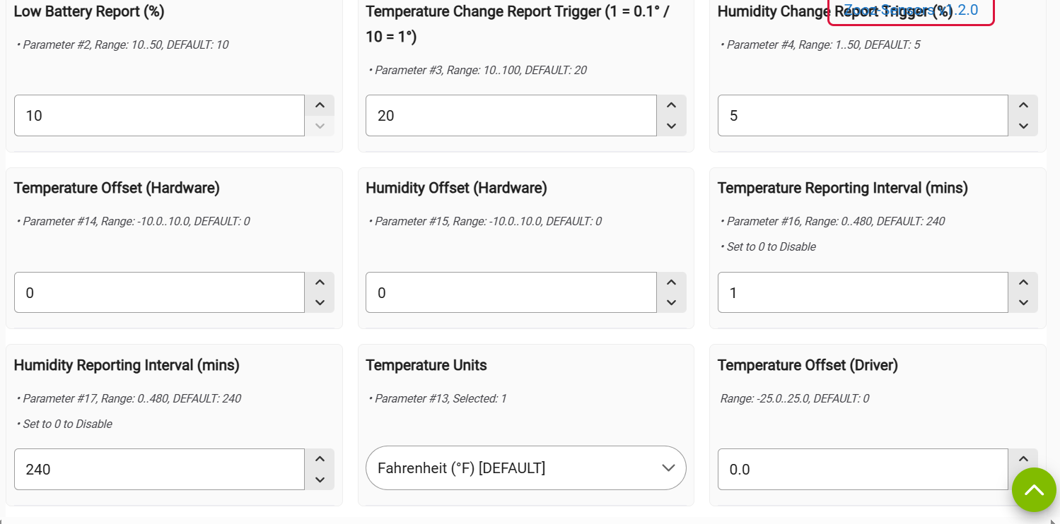

I'm not sure if you have any tips for a similar problem. I'd really appreciate any help. I updated the ZSE44 to update the temperature every minute. I had it working a few days ago but now it stops updating at all. I tried excluding and including it a few times. It gives one or two temperature readings then nothing. It seems when I adjust the setting to update every 1 minute it give a reading then no more. Here are my settings.
A 1-minute reporting interval seems pretty excessive, but since the parameter range allows it, I guess it should work.
What (device) firmware is your 44 on? 2.30 is latest from Zooz, and although they haven't yet updated the 44's firmware change-log page, in the Zooz community forums, they did say that 2.30 has "resolution of the temperature reporting issue".
Zooz said they'll get the change-log pages updated once they finish handling all the BF/CM sales.
I use one 44 used primarily for temp monitoring, and I just checked its logs -- it's reliably reporting temp ~30 minutes (as set/desired) on 2.30. But I also don't recall having any interval-reporting issues on previous firmwares, so :person_shrugging:
Then set it to something else.
If you NEED 1 minute reporting and its not working right you would have to contact Zooz. As @hydro311 said, it could be fixed in this latest firmware update,
