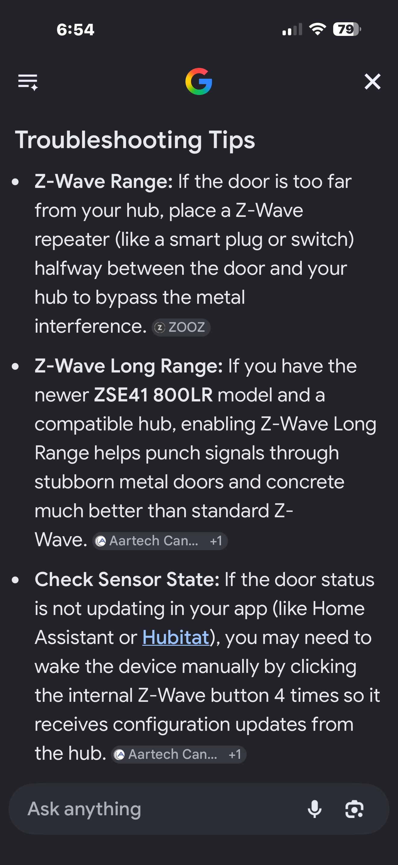

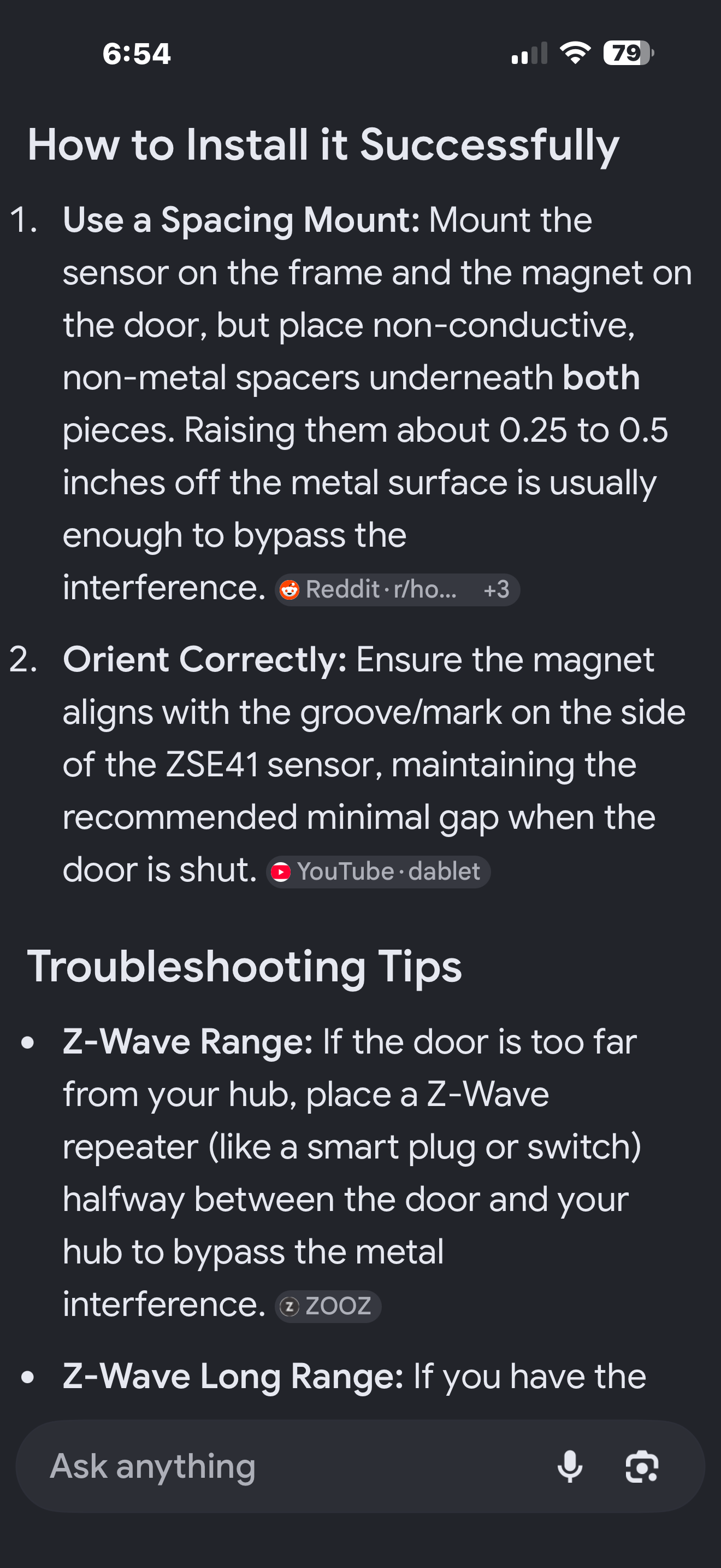

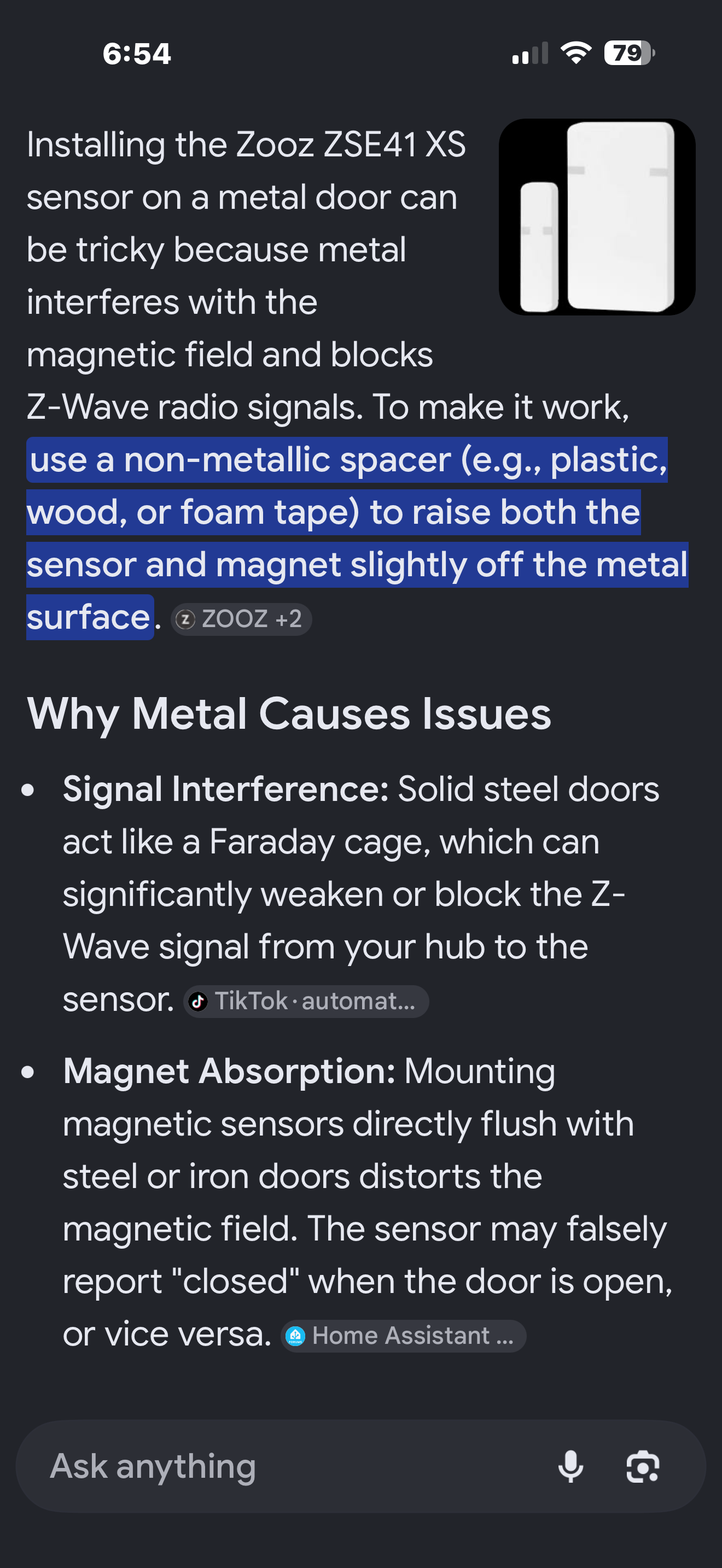

You mean why are they metal or why the advice to add a spacer? Metal doors are quite common at least around here. As for the need for a nonmetallic spacer…
