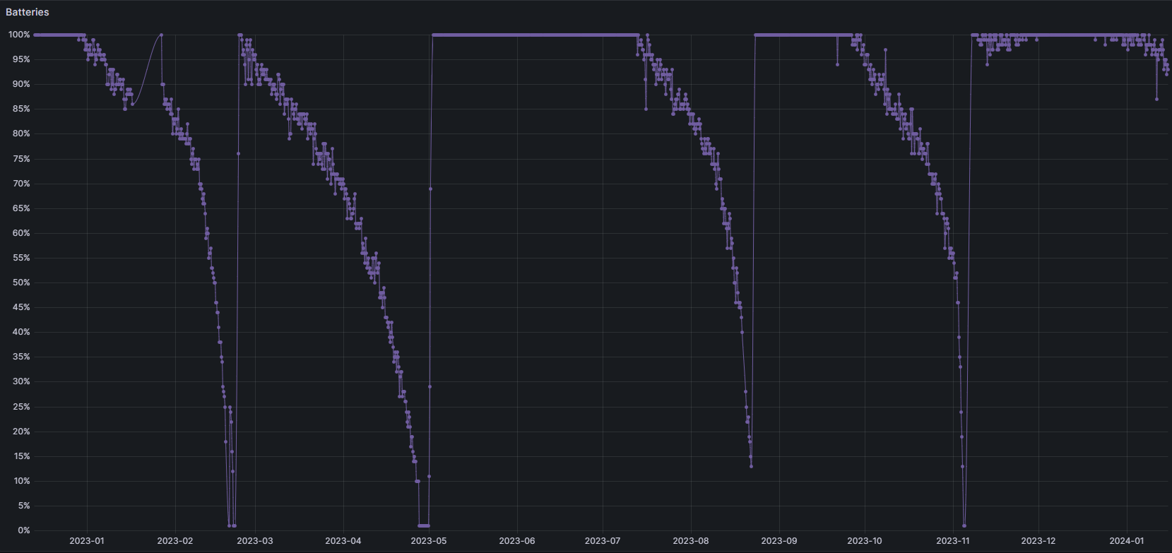

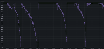

Its this, the voltage will drop due to cold even if the battery is still OK. I have a ZSE44 in my un-heated garage and it will report 1% all winter but keeps on working.

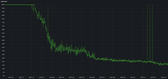

ZSE42 700 Leak Sensor (CR2032). About 15 months so far but it is holding out at this lower voltage. Need to do a test today and make sure it still works with the low battery.

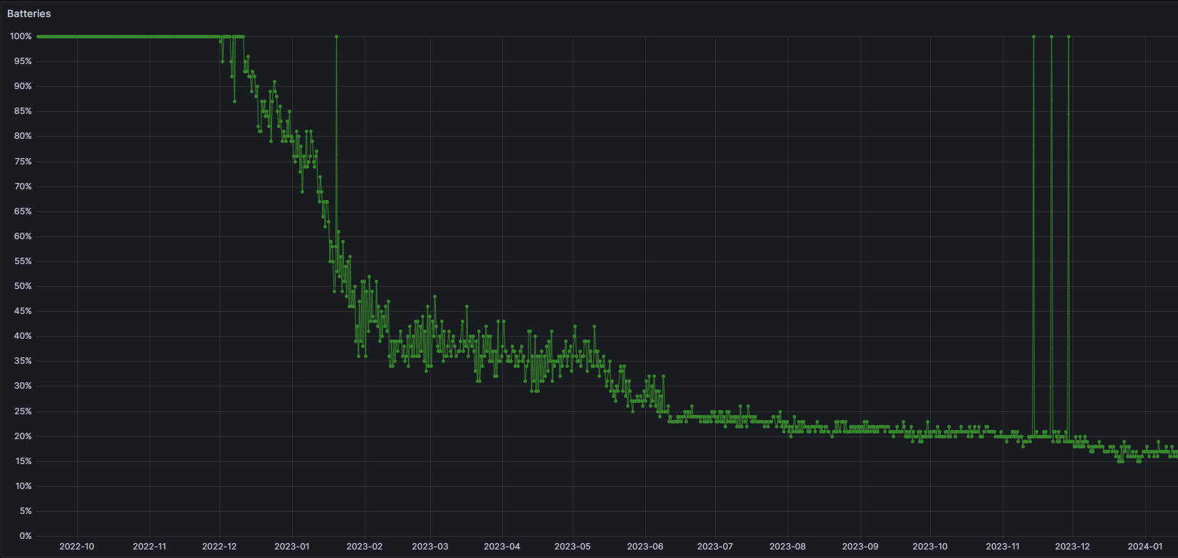

ZSE11 Multisensor (2x CR123A). This thing is terrible with batteries. Need to just wire it to USB power.

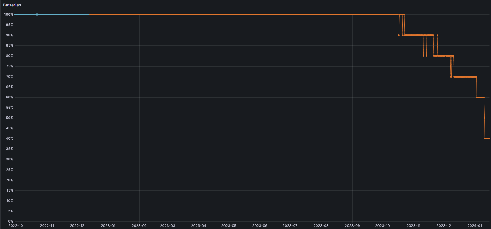

ZSE40 Multisensor (1x CR123A) This one on the other hand works great
