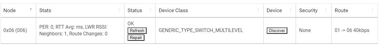

You probably have an incompletely paired device. Please post a screenshot of your Z-wave details page where you saw those columns of the route and speed and so on.

Yep, see that Discover button, that is indicating that the device isn't paired properly. This might take a few steps to fix.

Your device is not paired, that is what is referred to as a ghost. You need to remove that. I can't remember which option is best to try and remove it. Hopefully you won't need a Z-Stick.
Perhaps someone else can chime in, but what you want is a remove option listed under status. You can click the refresh and the discover and it may take a few tries. Once you see remove then start clicking that. Again it can take a few tries, if I remember right. I think if you can kill power to the switch it will help.

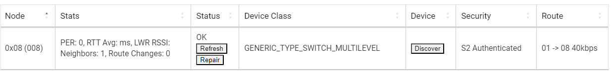

However when I go back to the Zwave details I am now in this state;
I feel like I am running out of ways to try and move forward.
That procedure seems correct. I have a few Zooz toggle switches, Zen73s, they include the same way. Did not have any issues they paired up first try. Did you try doing a Z-wave exclusion first? Make sure after exclusion you get the message unknown Z-wave device excluded. If you can't get it to exclude then no need to try and include it. If your only 8' from device and it being a C8 I would think signal strength is not an issue.

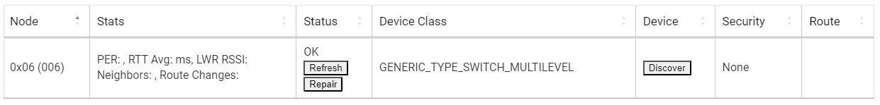

Before you start the pairing process look at your z-wave details and make sure that entry you have posted a screen shot of is gone. Since you only have one device just resetting the Z-wave radio is the easiest way to get rid of it.
You are correct - every time I have started the inclusion process by whatever method I have checked to ensure there is no entry in the Settings->Z-Wave Details page. And yes, Factory reset of the switch and Z-wave radio reset seems to be reliably removing the entry.
