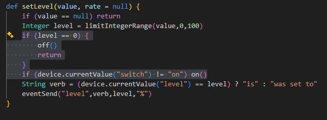

Most Drivers contain statements in setLevel() method to turn the light on if dim level is >0 and switch is not on, and off if it equals zero.
