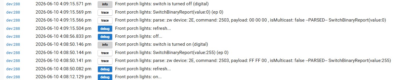

Use a PC if you have one, and use the web admin interface, and directly on the device page for the device. Open the hubitat system logs in another tab. You are using my driver from the sounds of it, turn on trace logging on the device. Run the On / Off commands from the device page and see if the state changes within a few seconds. If not then try running Refresh. Take a screenshot of the resulting logs and post. (You will need to join the owners group to get access to post images)
Thanks for responding, I hope I got everything you asked for. You mentioned doing a “Refresh” at one point, other than a page refresh of the browser I wasn’t sure if there was another type of refresh to do in Hubitat.

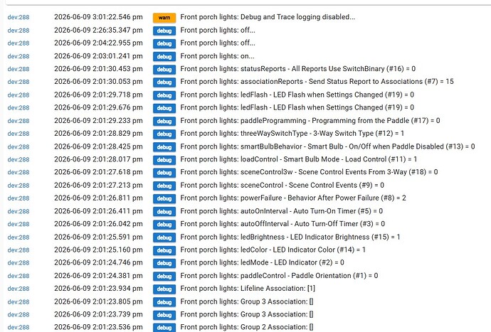

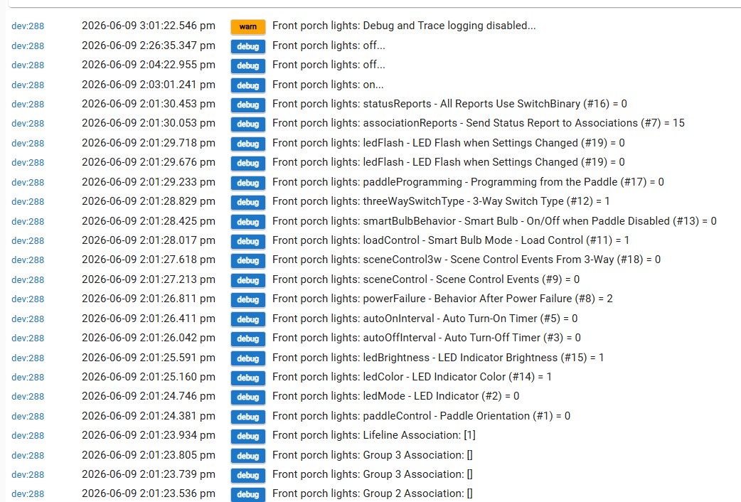

Looks like you turned on Debug logging, I asked for Trace which has more details.
Configure is not needed, did not ask for that.
There is a “Refresh” command ight on the device page.
Also may be a good idea to check all the device settings and make sure they are set to the indicated defaults. Sometimes weird settings combos will make the device not work as you would expect.
Sorry, no Configure this time and Trace logging. Also checked defaults and only found one and that was Parm 12 - 3-way switch type was set to “Momentary Switch”, which I changed to default of “Toggle on/off switch” before retesting.

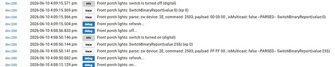

After turning on trace logging I pressed On in device page, status unchanged until I pressed Refresh and then pressed Off and status unchanged until I pressed Refresh. Screenshot here:

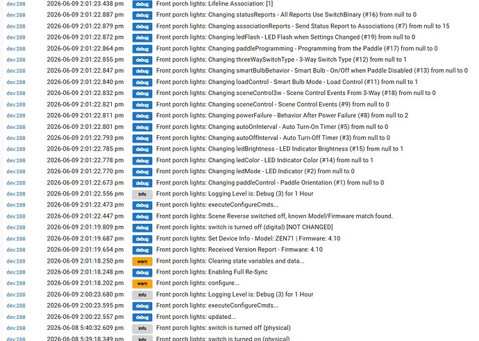

What is the switch firmware, it would be on the Device Info Tab > Device Data.

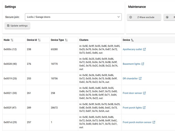

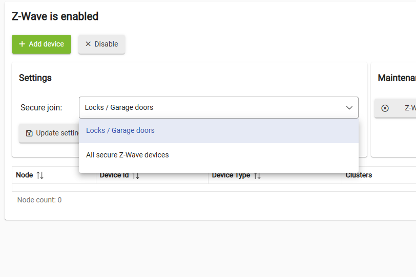

Also check the Zwave details page and see if it shows if it is paired with security or not, I think the C5 supports S0 security? Not sure how these newer devices would pair, I assume it should be no security.
Zooz has made some updates which is possibly making it not report its status back automatically, however with no security it should still be reporting.
You could also try excluding it and then including again, in case something went wrong during the pairing process.
The option for S0 on the C5 is "secure join locks and garage doors" or "All". Hopefully they don't have All set.
Firmware for the ZEN71 is 4.1.

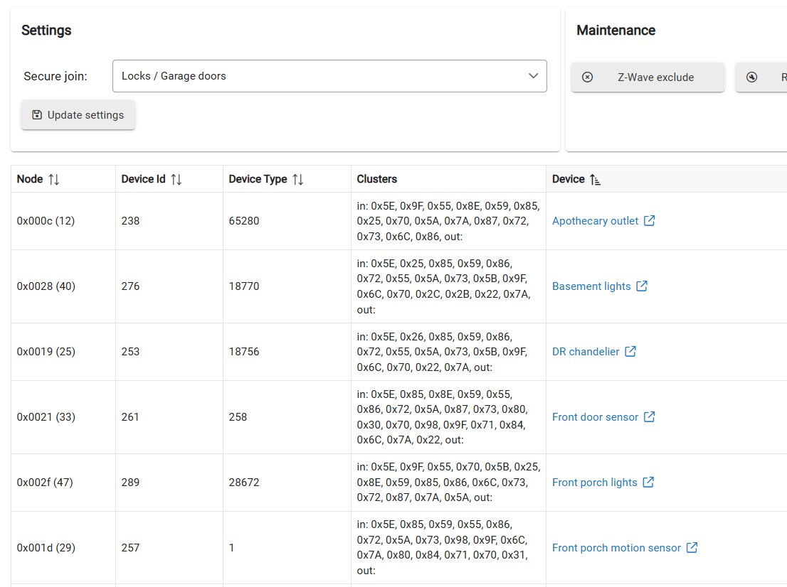

From what I understand on the attached note I would see 0x98 if S0 is present.
I have 3 devices in this location, light switch, motion detector, and door sensor.
It looks like the motion detector and door sensor have 0x98 and the switch does not.
My secure join is set to Locks/Garage doors.

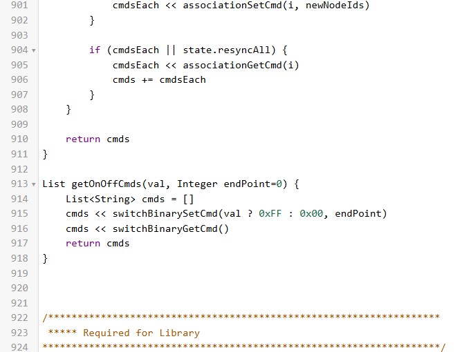

You can try patching this function that is on line 913 of the 2.02 driver: Hubitat/Drivers/zooz/zooz-zen-switch.groovy at e8e962d3985653e87c6872815edeff75c65561b5 · jtp10181/Hubitat · GitHub
Replace entire function with this:
List getOnOffCmds(val, Integer endPoint=0) {
	List<String> cmds = []
	cmds << switchBinarySetCmd(val ? 0xFF : 0x00, endPoint)
	cmds << switchBinaryGetCmd()
	return cmds

Glad it worked I just keyed that right into the post without validating anything.

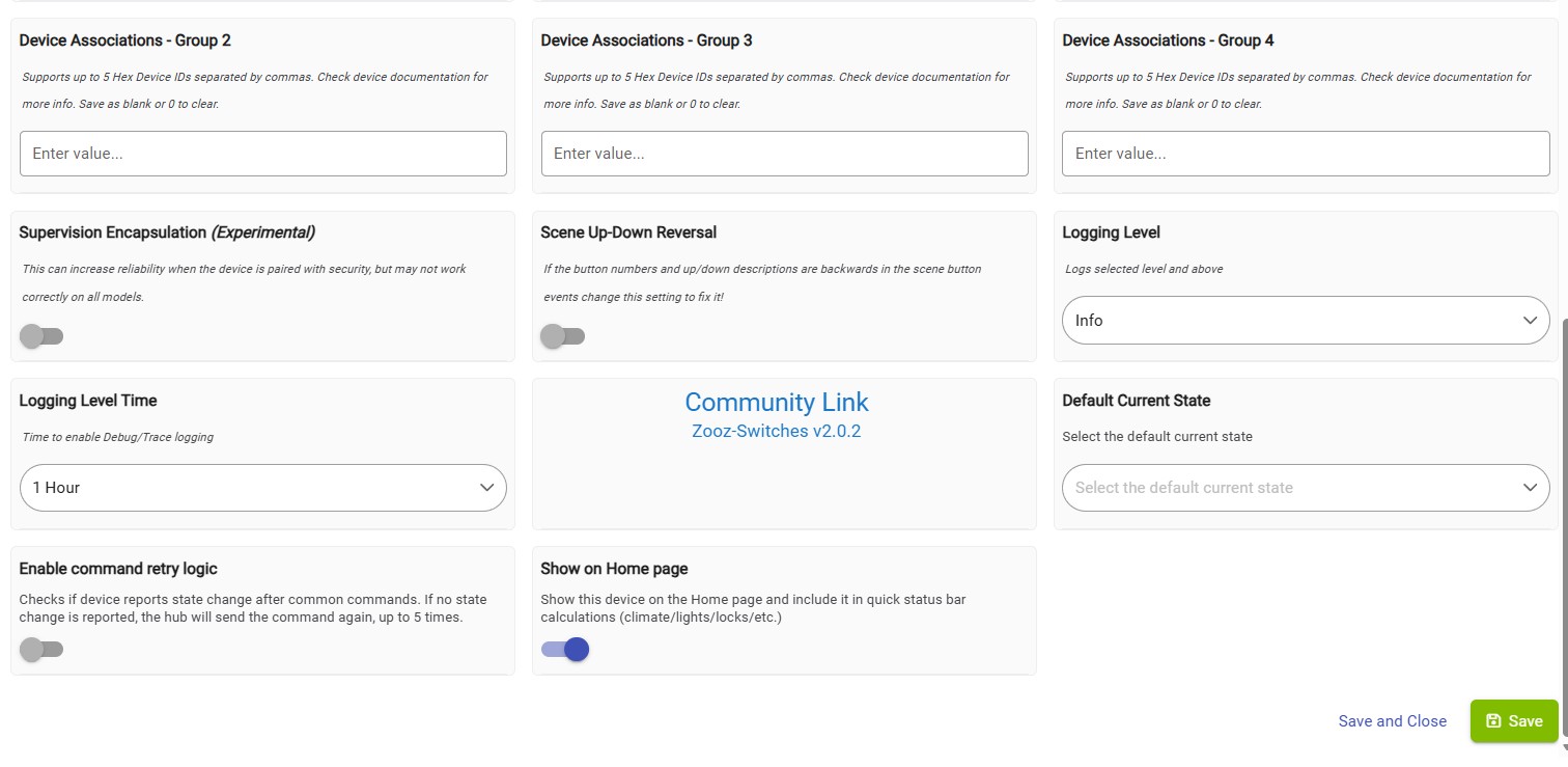

So what that does it just immediately asks the device for a status update, same as pressing refresh. Typically in the past they have always sent it back automatically. Zooz has been working on reducing redundant messages and with S2 security and supervision technically you don't need it, because the supervision response confirms the action. I don't think the C5 would work for either so not sure why it would be kicking in on your hub. (I warned Zooz this might happen :wink: but the devices I did limited testing on worked as expected still)

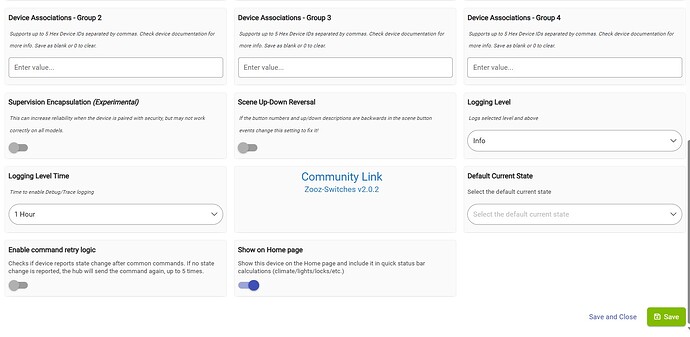

You do have this setting turned off correct? That's the only thing I can think of that might make it stop sending the responses back normally.
Either way, the patch is pretty harmless, One extra back and forth when you change a light wont hurt your zwave mesh.
True - Supervision Encapsulation is OFF
