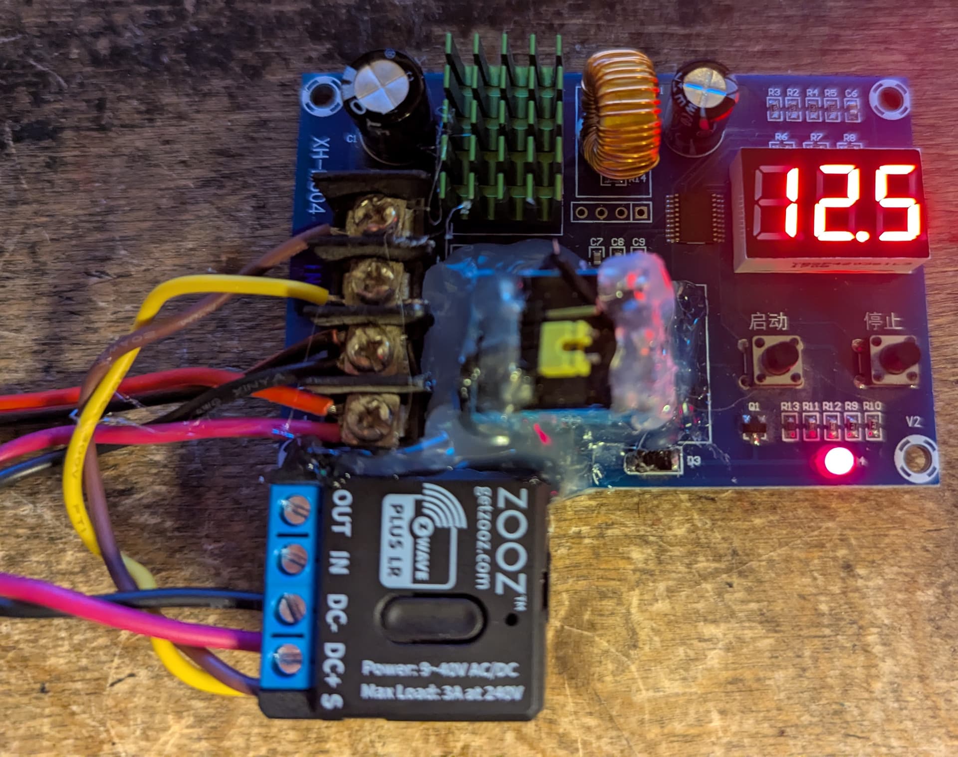

Battery Charge controller connected to Zen58 input
