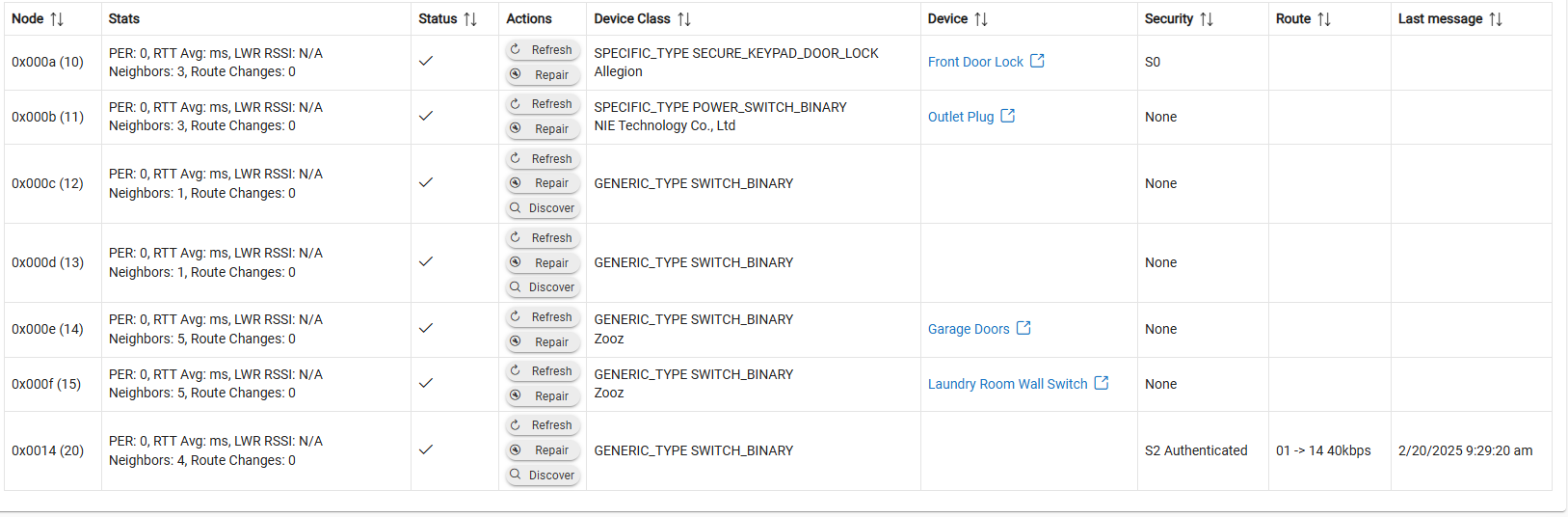

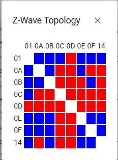

Here are a couple screen shots of my zwave details page and topology:
You have almost as many dead nodes as you do working ones. All the ones with no device listed you should try to remove. Either from failed pairing or the last one is probably the ZEN51 you force removed. That might be what is preventing you from adding devices again.
Read up to section 3 here and see if you can remove some of them: How To Remove Ghosts using hub tools or a UZB Stick
I was able to remove those dead nodes with the instructions you linked to. That looks like it fixed it.
