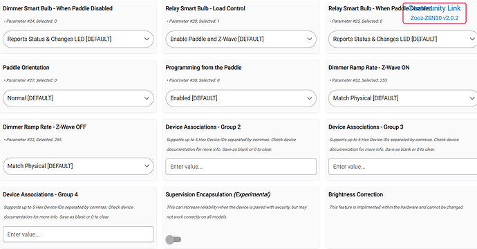

I'm using my Zen30 800LR dimmer switch to turn two Hue bulbs on and off via switch binding. However, when I turn them on, they initially light up at 100%, then suddenly drop to 1%, and gradually increase in brightness over several minutes. I'm using the community driver for the Zen30. Is there some parameter I need to change?

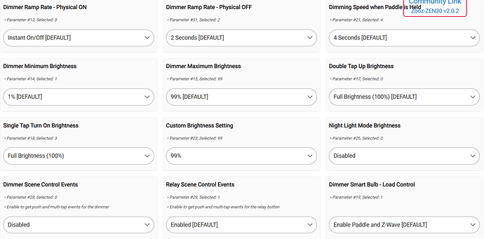

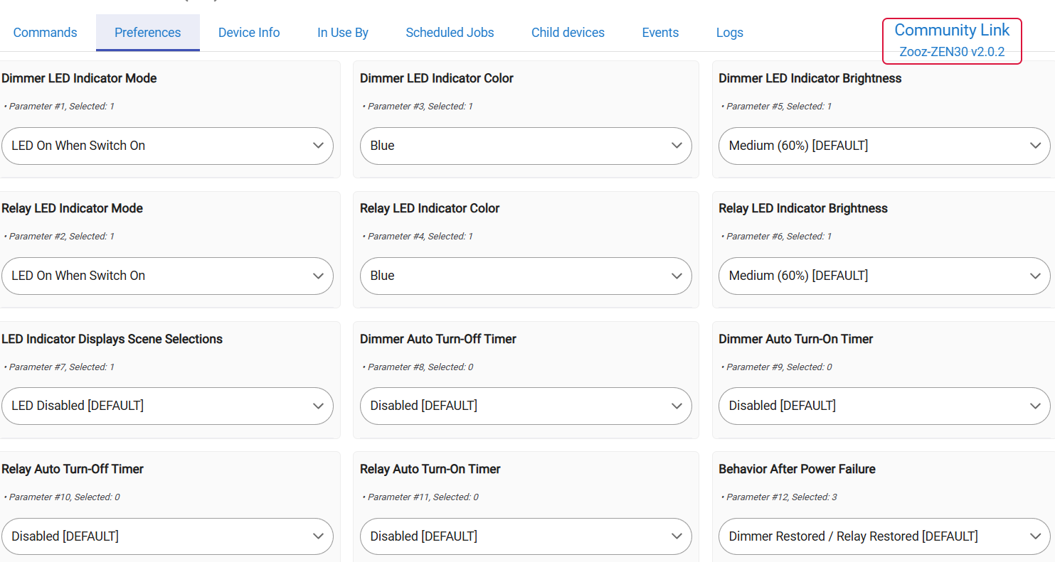

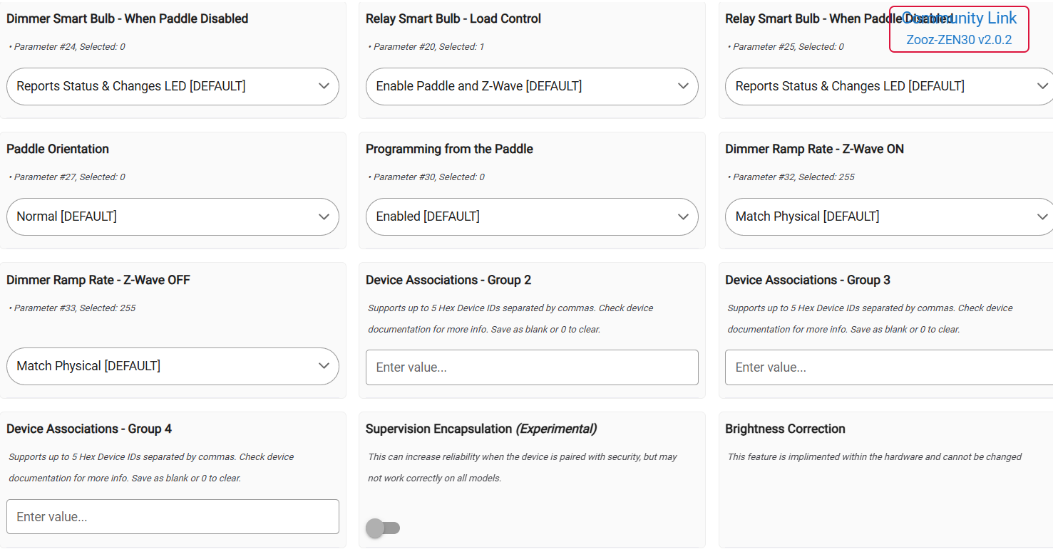

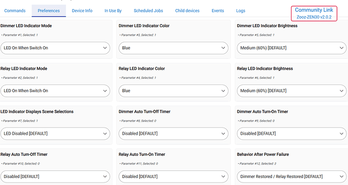

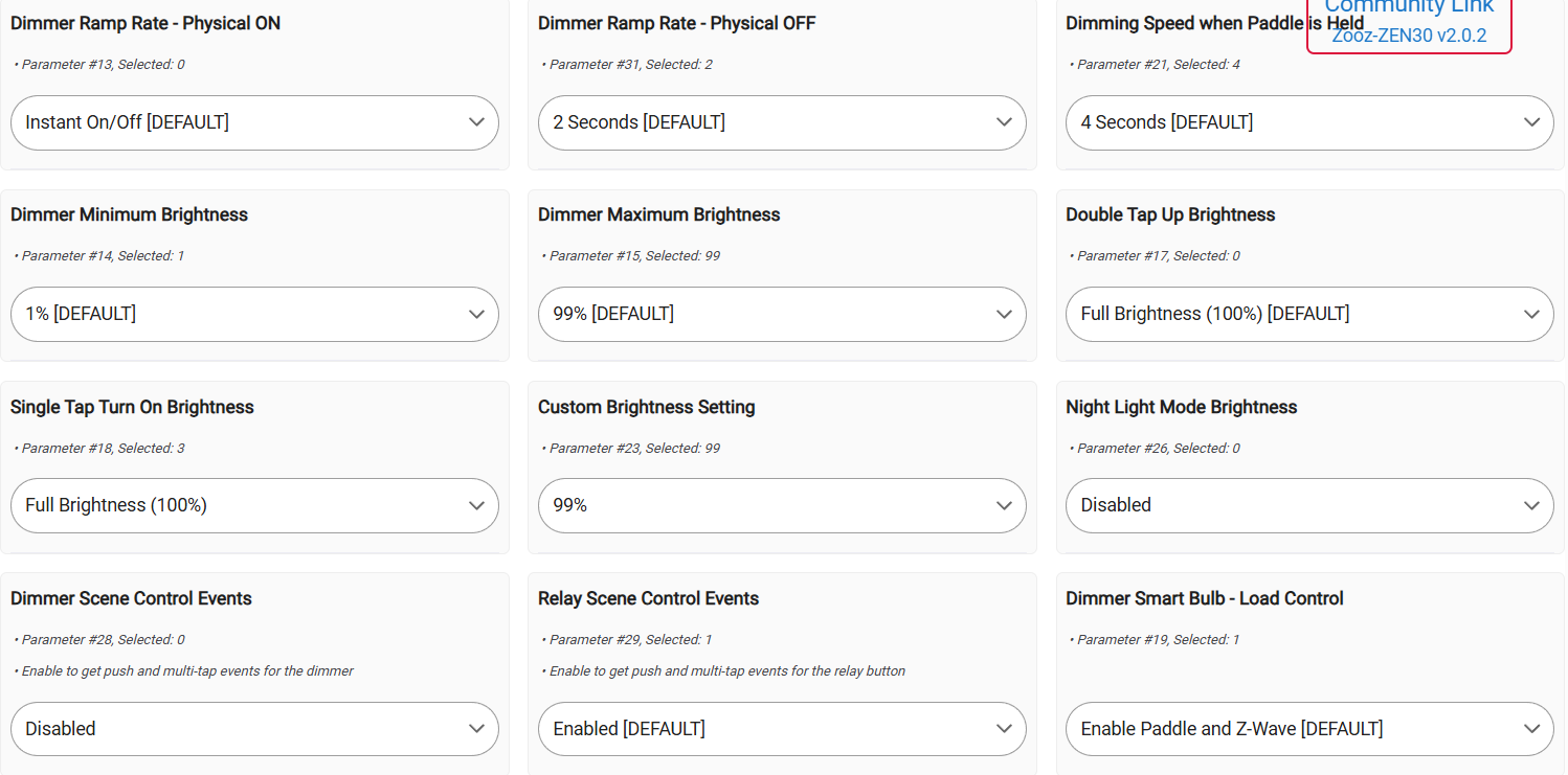

Go to one of the bulbs device page, and the events tab. Get a full page screenshot showing a section where you had the issue.
Anything else below that command-setlevel from the same time period?

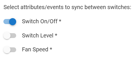

The switch binding app is causing the issue, it is setting a setLevel 100 duration 400 seconds.
Do you have any load at all connected to the ZEN30 dimmer?
