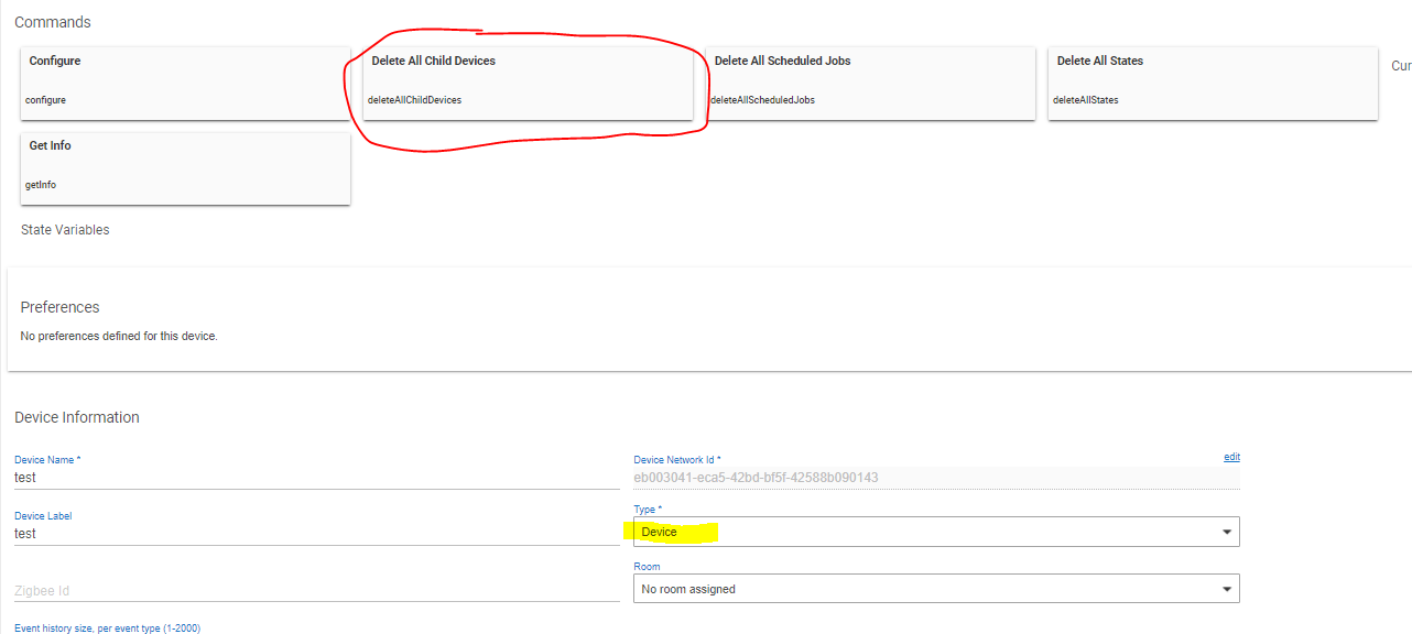

  2. I have a completely different device (Minoston Outdoor Smart Plug) which, when I added it, was added as a Zen25 Device with two child devices. It still works, I can still turn it on and off. But I'd rather it be correct. When I change the device type to "Generic Z-wave plus smart switch" it still works but the child devices are still there and I cannot remove them.

Temporarily, change the TYPE to DEVICE. Then Click "Delete All Child Devices"; then switch back to original device type.
Thank You!
