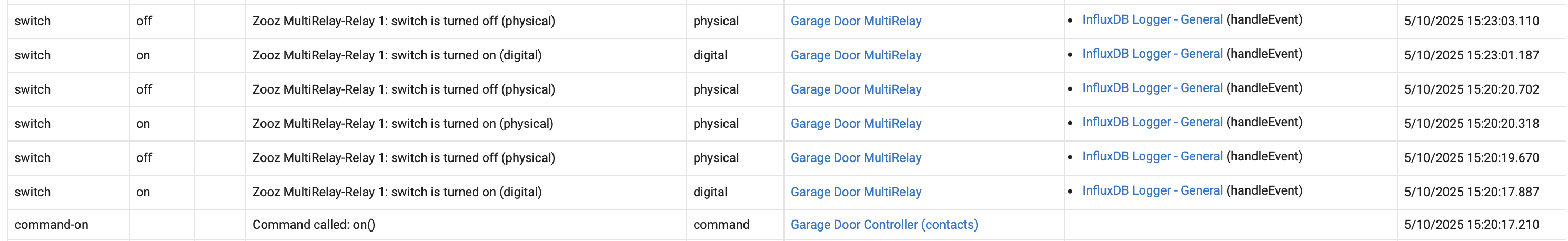

I have a Zooz Zen16 being used (only) as a garage door opener on relay 1. I created my own garage door controller using rule machine. As you can see from the logs, when it activates, the signal is sent. I then have the Zen16 hardware set to automatically turn off relay after 1 second. But for some reason, the relay is creating additional activations of the relay multiple times after the command, which is causing my garage door to stop mid-cycle, reverse, stop, etc. depending on how many times it does it. I thought maybe it was the "retry" device feature that Hubitat recently introduced, but I checked and that isn't turned on for the parent multirelay or the relay child device. My app also isn't sending multiple commands, so I can't figure out what's going on. The relay itself just seems to be sending multiple commands for some reason. Has anyone sle seen this? Any thoughts on what might be going on?

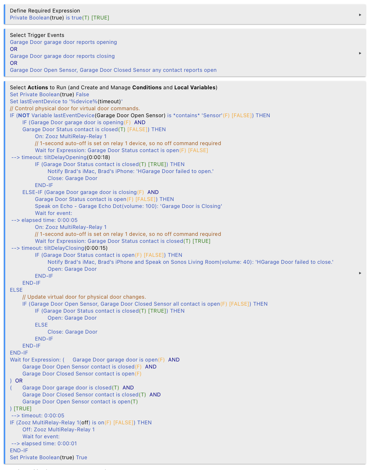

Showing a picture of the rule may be helpful too.

I'm not using the Zooz app because it doesn't allow for 2 contact sensors instead of a tilt sensor. That's why I went to my own... I was having issues with tilt sensors. But if the above doesn't work, I'll try turning off the "auto-off" and put an off command into my app. Maybe it's the auto-off functionality on the device that causing the issue, so doing the off in my app would solve that.
