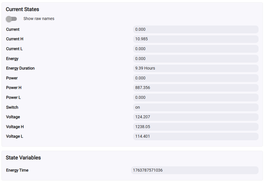

I use Zooz Power Switch driver. Does your Device Info page not look like this when using that driver?

Don't forget to press "Configure" on the command tab, you need to do that after changing a driver type, then reopen the device. The missing attributes should show up after configure command is pressed.
Thanks, did not know that.

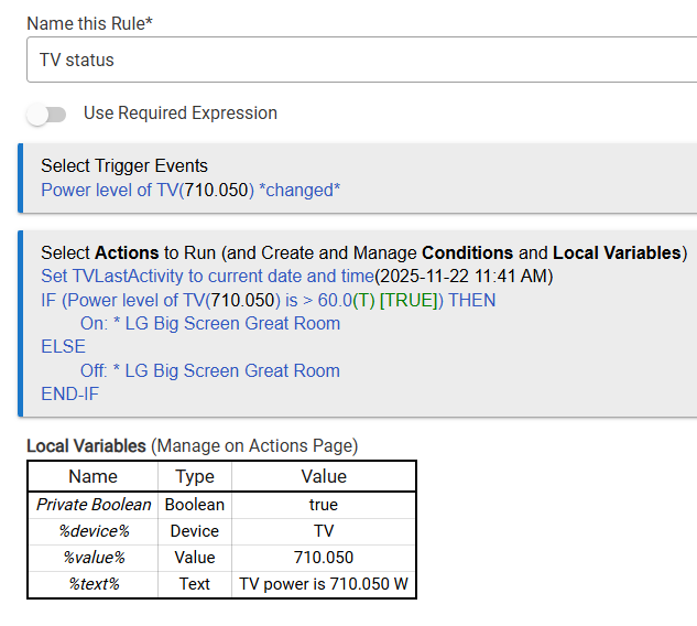

You would need a less than value, not a discrete value for power. Rule machine gets tricky for that, as the power meters will continue to report that the value is < your power threshold, so you have to limit the rule to only run the first time it sees the threshold crossed.
Since you are new to Hubitat, I highly suggest you check out Webcore for rules instead. That rule is easier in Webcore, as there is an option for "Falls Below" a value, that will only trigger once when the power first falls below your threshold value. In general, I just find Webcore easier for everything, once you learn how it works.
I use the power attribute, which I believe is watts. I often use power meters to try and derive the state of a device that is controlled through a Broadlink IR device. For a three speed fan, you can tell if it is off, low, med, or high based on the power consumption, for example. Power meters are handy devices.

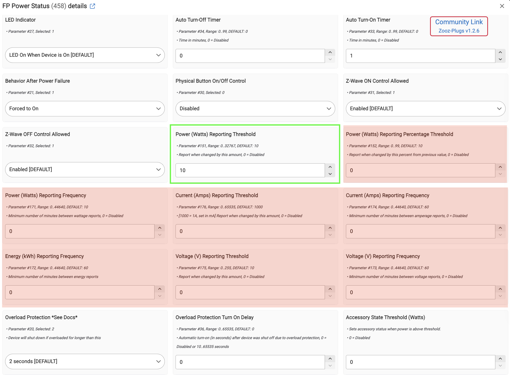

so what is the difference between Energy reporting interval and power reporting interval and electrical current reporting interval?
Basic Rule
Says when Power level drops below.... are they speaking watt? it does not tell me. I put down 10 for the hell of it, but right now, I am kind of lost as to what is apples and what is oranges.
Yes, power = watts. As shown in the screenshot below, the Z15 community driver parameter page does actually say that (along with current = amps, energy = kWh, and voltage = V).
Here's an example of my Z15 setup for monitoring (not controlling) whether or not my fireplace is on or off... A 10-watt Power Reporting Threshold is what I discovered works best in my particular situation here.
I have another Z15 that does the same sort of monitoring for my dishwasher - it just uses a higher Power Reporting Threshold value.
For both of my Z15s, note that ALL of my other energy-related reporting options are set to "0" because I don't need them and don't want them clogging up traffic.
