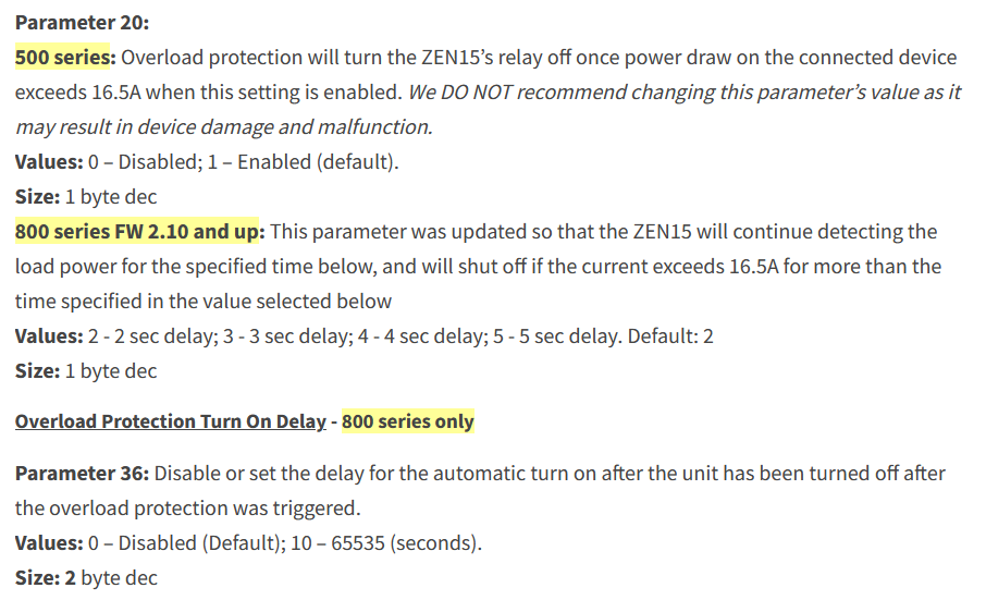

I thought the below was interesting.
There are parallels with the ZEN04.
I found that the ZEN04 reliably turns off at a certain current (don't recall).
But, if you set Auto/On to whatever you want, it'll reset.
I've used the ZEN15 to monitor an LG Combo Washer/Dryer, 125v, for several loads.
ZEN15:
