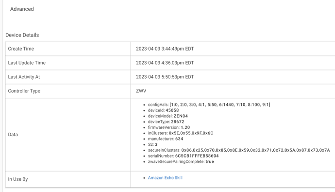

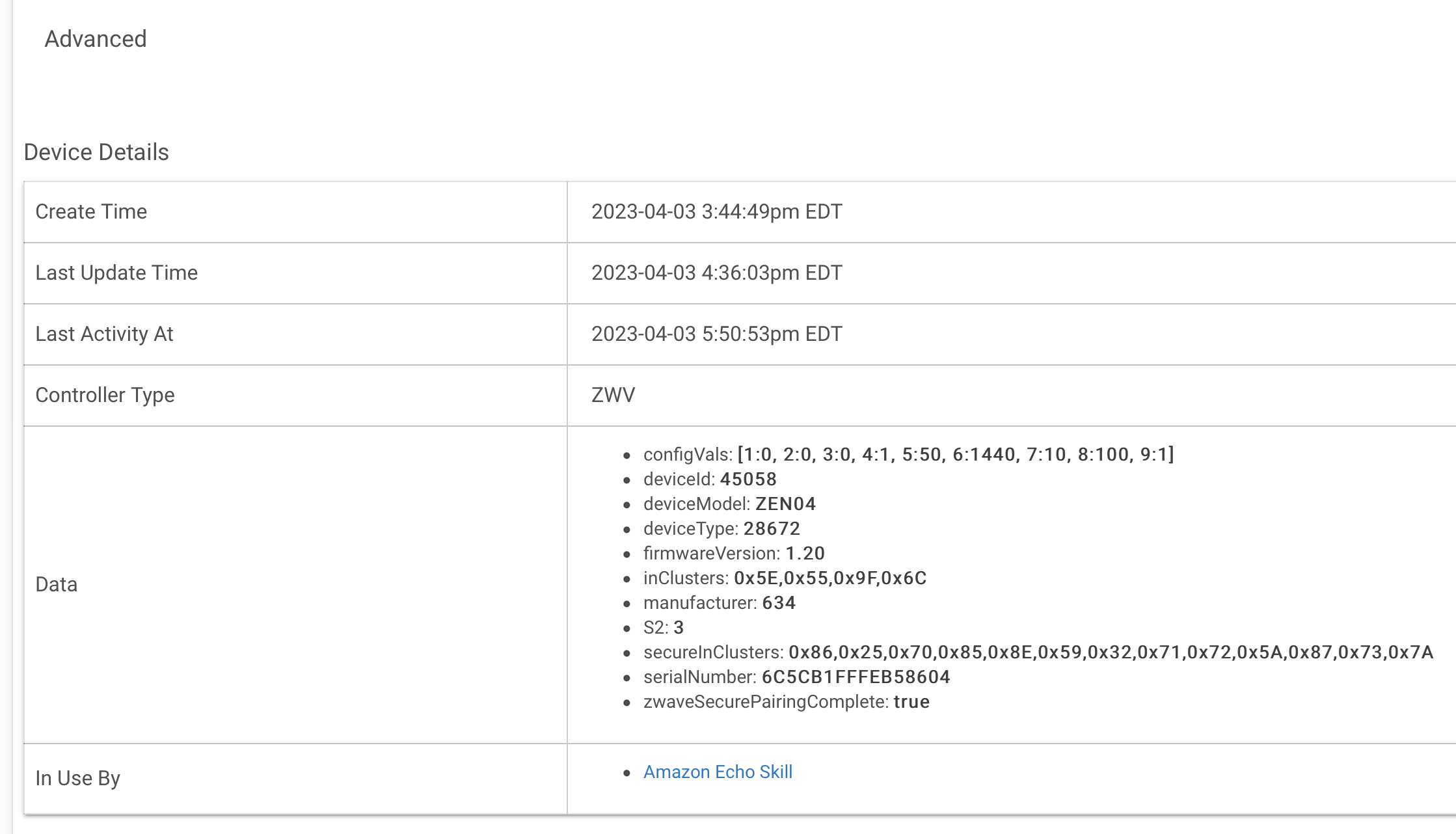

Commands & States
Device Information
Advanced Device Details
Anything look weird?
No everything looks fine to me. Maybe try powering down the hub and restart it?
