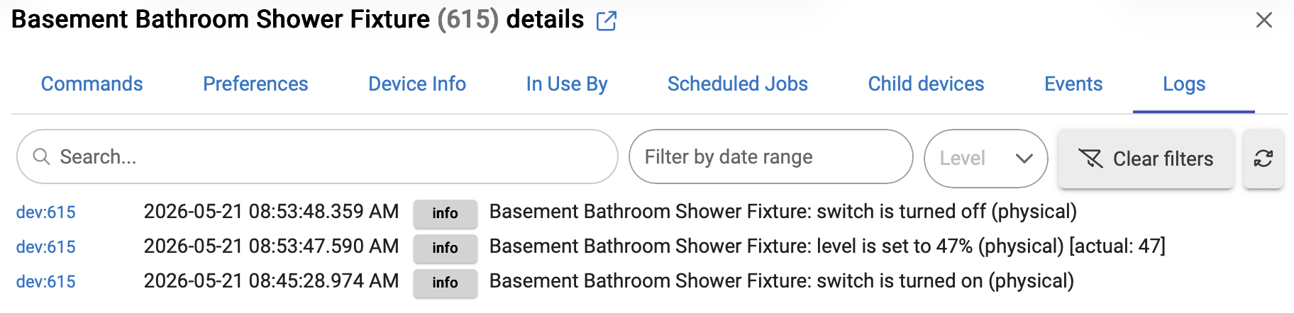

I took the time to video this when it happened this morning, but I can't upload this to the forum. I then checked the logs, and it recognized me turning it on, dimming it, and then turning it off. It did not register the downward taps between turning it on and dimming it. Device details and logs are in the images below.

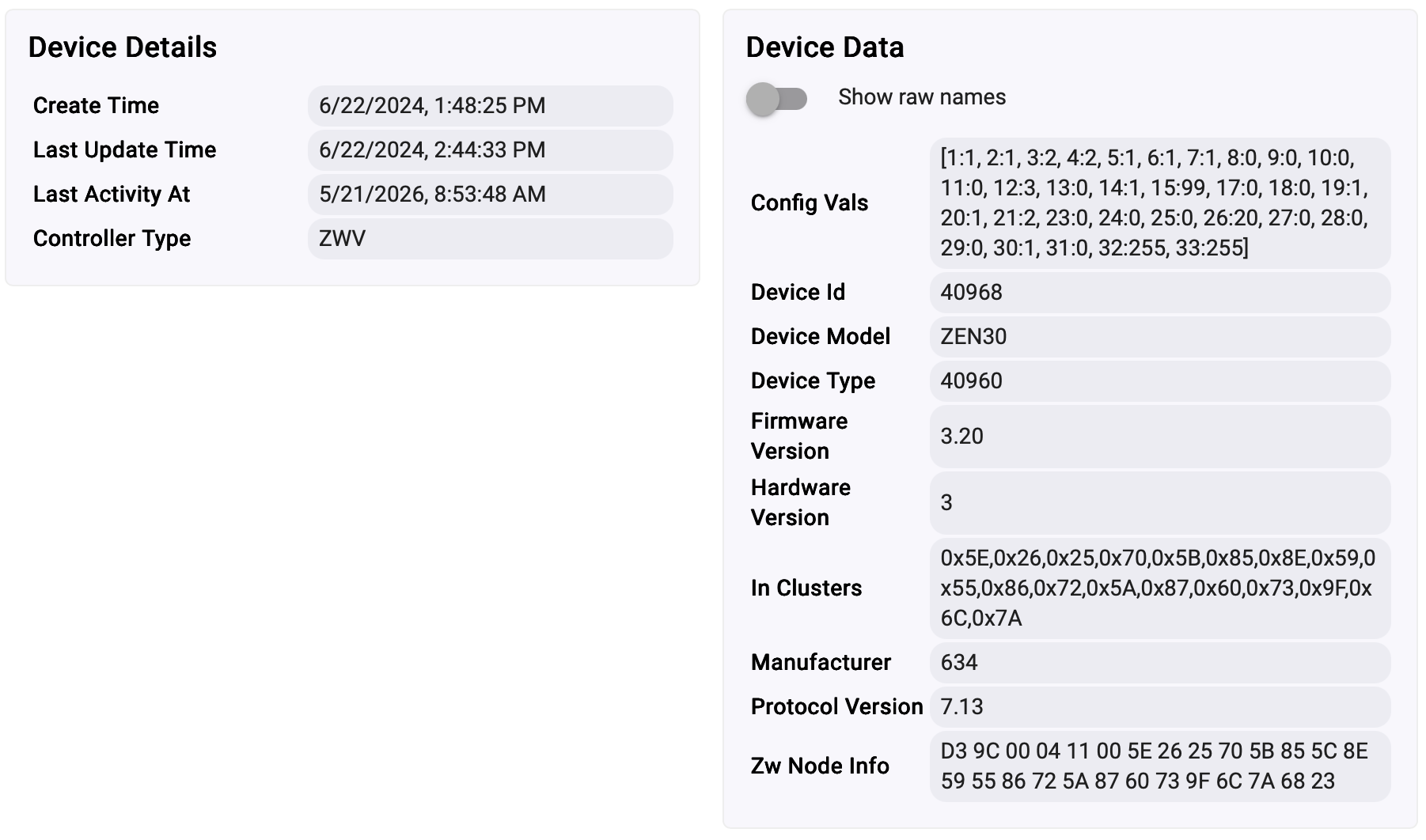

I'm running a C8-Pro on Platform Version 2.5.0.123. The switches are operating on the Zooz ZEN30 Double Switch driver by jtp10181 (v 2.0.2). Device info in the image below.

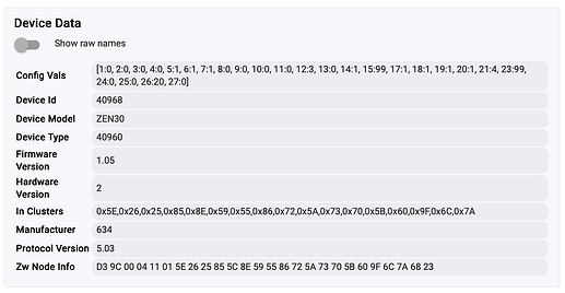

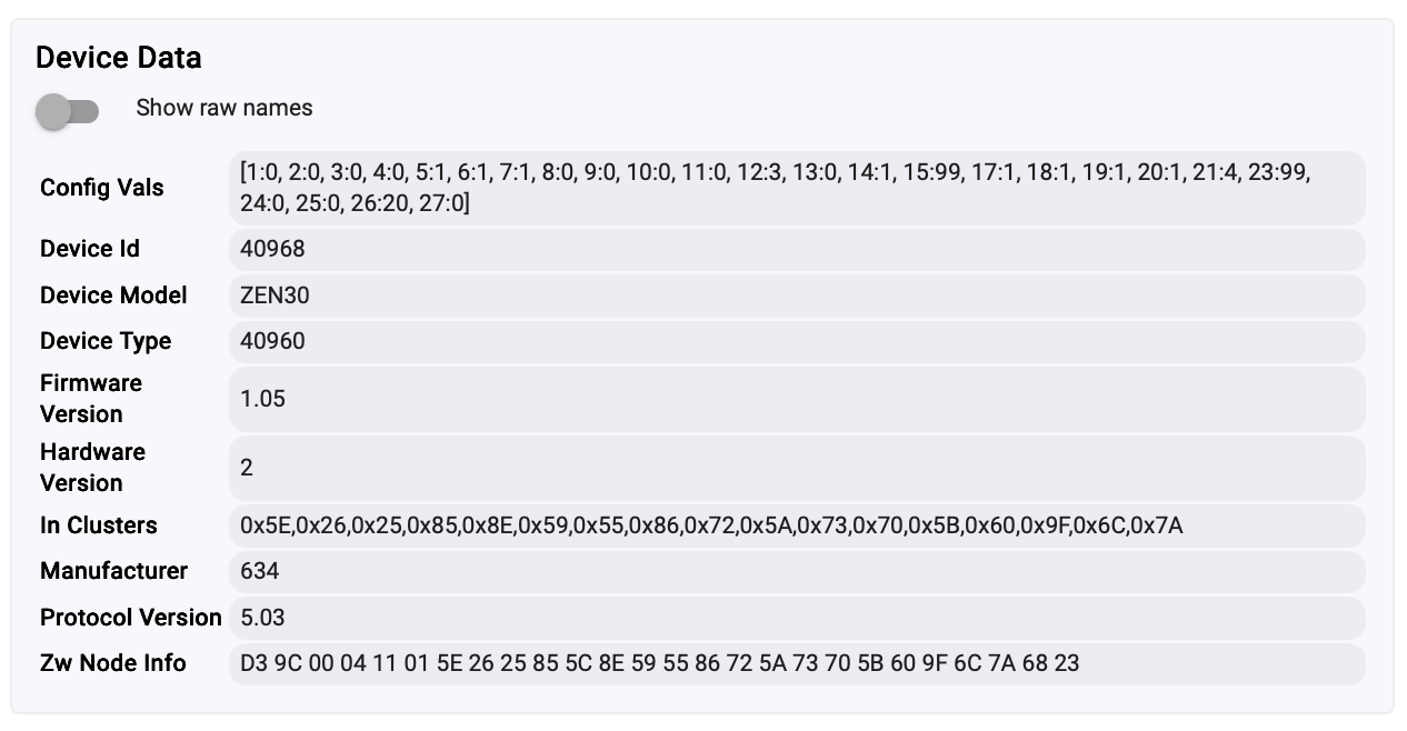

I am not able to observe this behavior with the three ZEN30 double-switches that I have. There are two differences between our setups. First, as indicated by the device data pasted below, all three of my switches are much older than yours. And second, they are using the built-in "Zooz Double Switch" driver.
