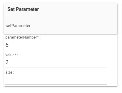

Relay brightness is parameter 6, and low is value of 2
You can set that via RM using the Set Parameter command like this:
(size can be omitted, it knows the size because its a define parameter)
Just send the same parameter values as numbers to "setParameter" from RM and it should work.

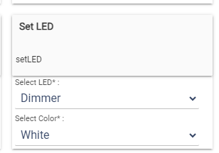

@hydro311 the ZEN32 set LED is totally different from the ZEN30.
You have to use the Set Parameter command on the ZEN30, the brightness is not part of the setLED command. It would be a separate line in RM to set the brightness.

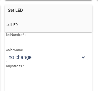

If you look at the commands on the device page they show you exactly what options they take, what order, etc... If you try something outside of that it will fail.
Look, ZEN32 command has 3 values, one is brightness
ZEN30 is totally different, it takes Dimmer or Relay, and the color. No brightness.
Its not a standardized command, I did it one way on the ZEN30, and the ZEN32 driver author did it a little differently.

The line is "Set Parameter"-> number -> "6" -> add parameter-> 0 (for 100% when open), or 2 (for 30% when closed). This is still not working, but it is not throwing any errors in the log. I am confirming the LED level by viewing the device page, switching the state then refreshing the tab of the device page. The color is changing as expected, but not the brightness.
In experimenting, I just now found that going into the device using "Set parameter" no 6, level 2, is not working and the following error arises:
This is the settings I am using in the device page:
I also tried 06 for parameter #, 100 for level, and "bright" for level-which was wholly rejected as expected.

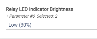

Here are the parameters, refreshed after changing states for both ZEN30 devices; bedroom and livingroom.
Bedroom closed
Living room closed
Bedroom open
Living room open
Apparently no one uses that function. Around line 686 replace the entire function in your code. I already have done this fix on a bunch of my drivers but had not pushed an update for the switches/dimmers pack yet.
The settings shown on the page will not change when using that command. It will show "1 Pending Change" until it has been changed back to your normal setting.
