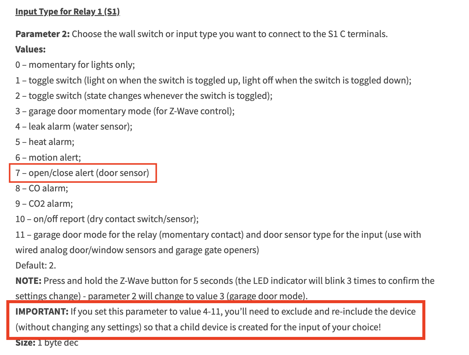

I have a gate opener, I am trying to change from the Mimolite to Zooz Zen 17. I have a dry contact (ports S1 and C). When the contacts touch, there is no reporting to the Bubitat. I cannot figure out what setting I am missing. Thank you in advance.
Is it a 800LR hardware version of the Z17?
If so, did you exclude and re-include it after setting it up as a contact sensor (per the Advanced Settings instructions)?
Thank you, I got it to work.
