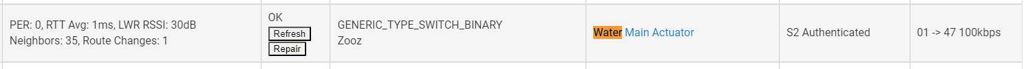

Mine has been working fine. I have it on my activity checker so if it stopped responding I would know within 24hrs. Mine is S2 Auth and direct.
