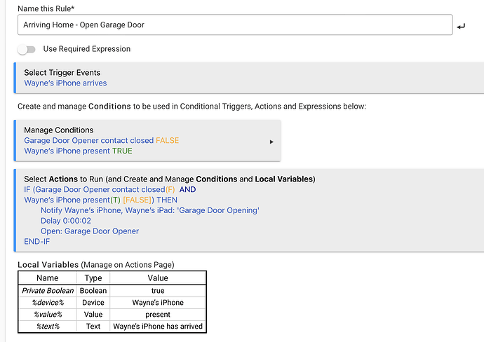

I installed the Zoom Garage door app today but it doesn't work and I need some direction as to the troubleshooting.
If I tap the open button, or approach my home, habitat says it opening and I get at the message, but I do not hear the relay change state. As a test, I used the relay child app and when I manually changed the relay state, the garage door opened...
Does anyone have pointers on where to start? If there is any thing else that is needed, please ask..

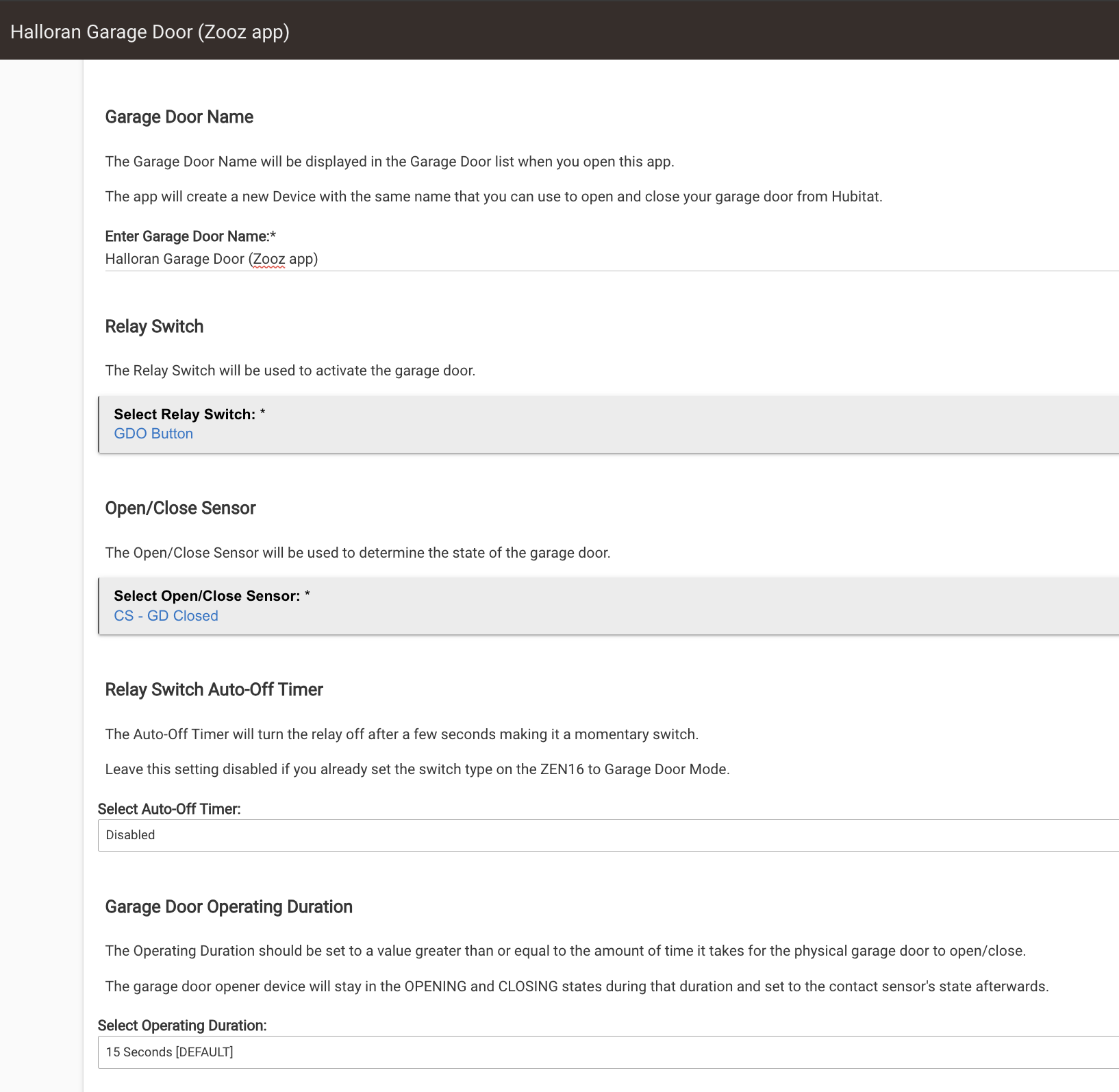

Can you include a screenshot of your Zooz GD app setup?

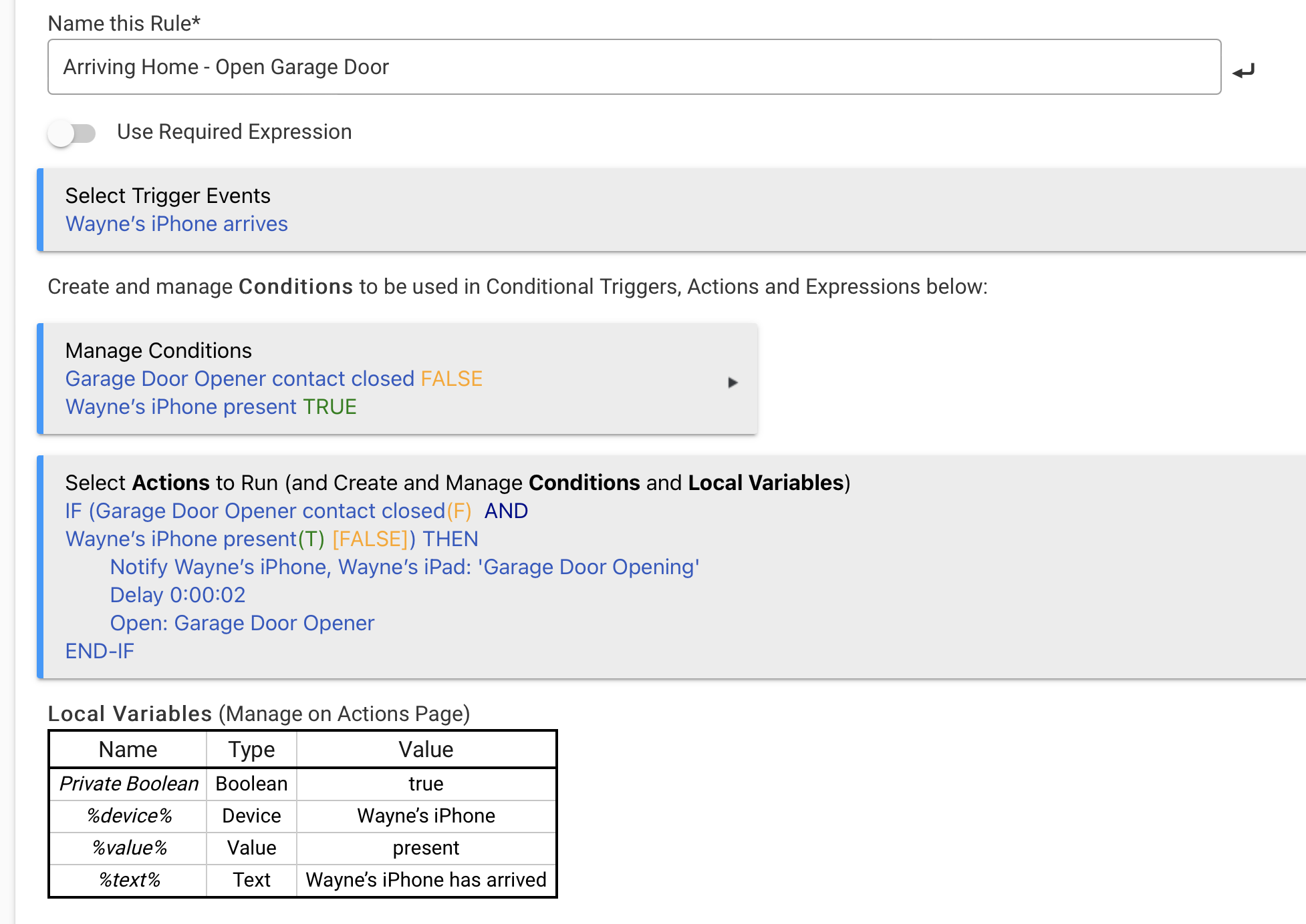

Like your other arrival rule in a previous post, it's not necessary to include the "phone present" condition -- that state is inherent to the phone-arriving event.
ETA - do you always enter the house thru the garage? If so, this rule makes sense. But if not, do you want your garage door opening EVERY time your phone enters the geofence?
Yep - Didn't think about that one.. Yes I only enter thru my garage door..

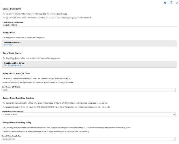

For the app shot, I meant the one that looks like this:

Food for thought, but I'd strongly recommend not activating a rule like this until you've verified (over some real-world time & experience) that your presence-sensing setup is working really reliably...
I myself would never open/close doors or operate locks based on my presence arriving/departing -- while my presence sensing works pretty darn good, I simply don't have that much faith in it. But I live in an urban core, so I admit paranoia about opening anything in the blind. Your circumstance may not have such concerns, but I still stand by my caution to vet performance before activating this rule.

Understood, I am only ever going to want it to open the door. I will continue to close the door myself.. I want to ensure the door closes.. I assume you mean pause the rule?

Did you set up the auto-off parameter for Relay 1?
If not, that relay isn't getting turned off & on correctly WRT operating a garage door... As @velvetfoot mentions, a GDO relay needs to be (or mimic) a momentary switch, which is what the GDO's dumb wall switch and remotes are. To activate the door (up or down - direction is irrelevant), the relay must turn on but then quickly turn right back off.
You can set that up with 1-2" delay via the auto-off parameter on the relay itself, or in most cases, the easier method is to use the "Relay Switch Auto-Off Timer" option in the Zooz GDO app -- the default selection is 2", and that works fine.
That option is Disabled in my Zooz app setup s/s above since I use the relay ZW parameter method instead.

I misunderstood the instructions above the setting and had it disabled…
I reenabled it and will test this afternoon and update you..

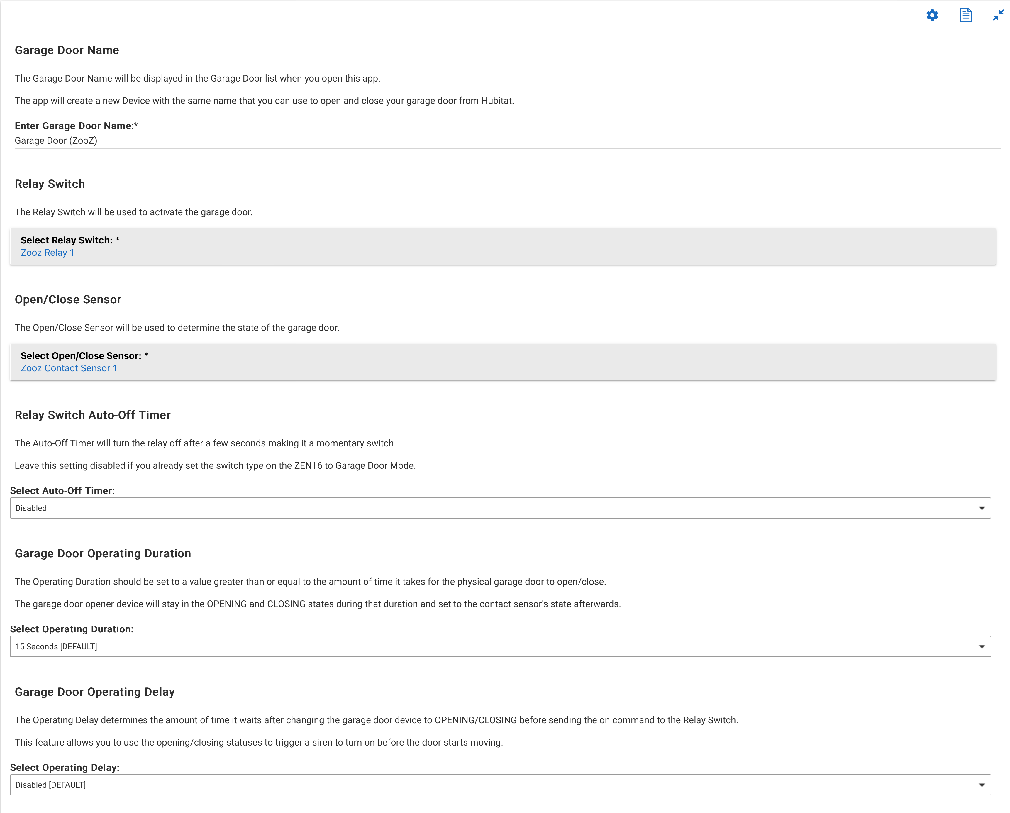

Changing that setting did not correct my issue....

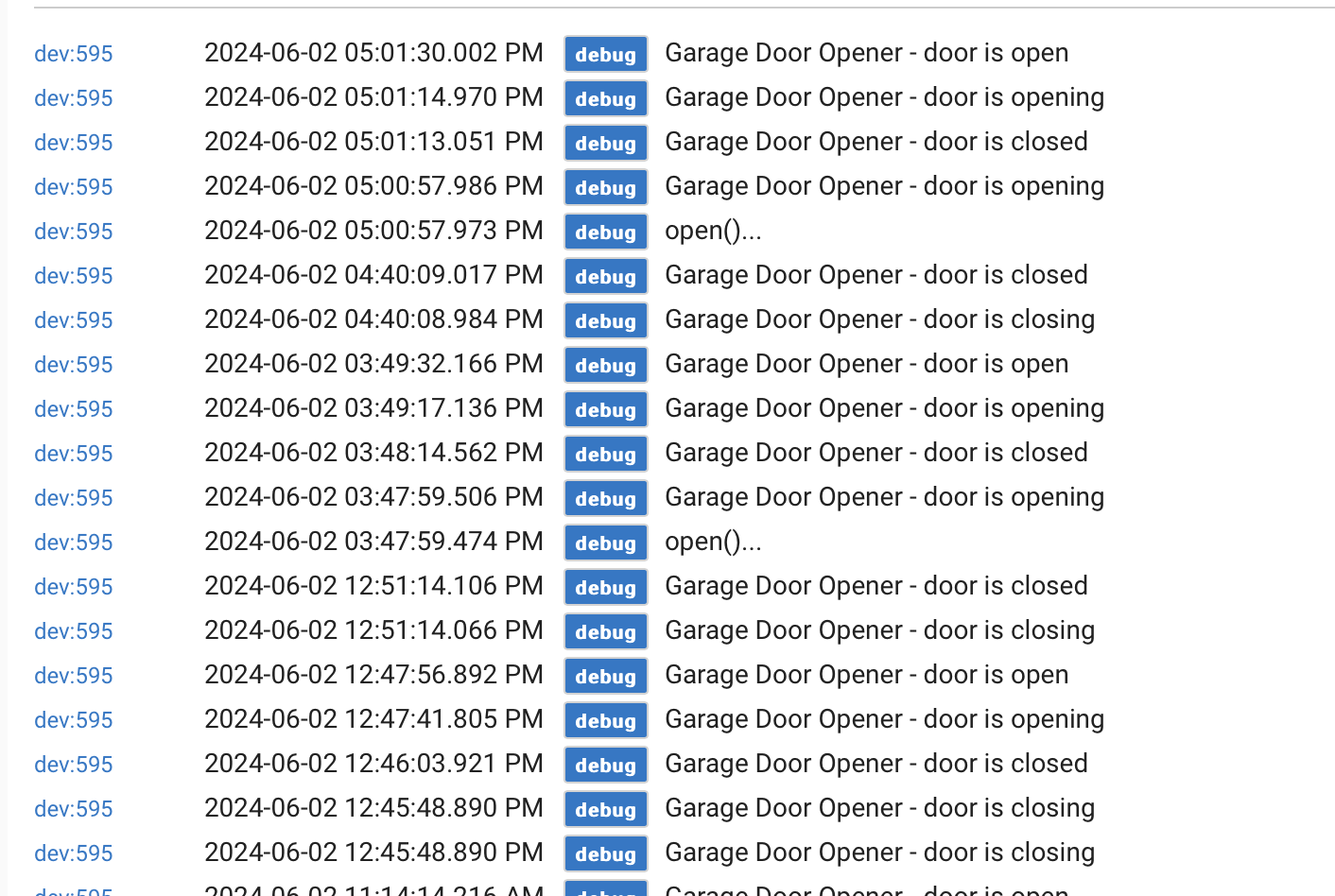

If I manually change the state of relay 1, the door will open and the sensor indicates the same...
If manual activation all works as adverstised, then I'm not sure what else to try... That Zooz app is pretty basic and is very tried-&-true... It's one of the oldest ZW apps still kickin' these days -- it originated from way back when in the heyday of SmartThings, so lots of folks using it over many years.

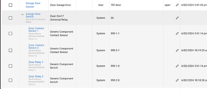

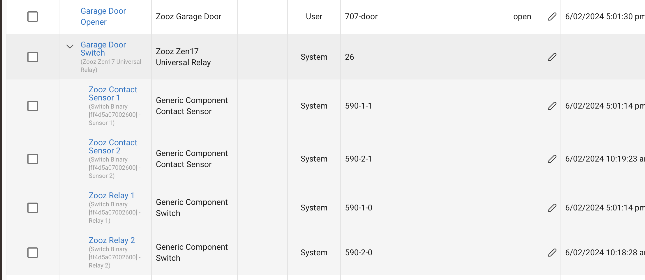

Post a screenshot of your settings from the parent ZEN17/16 also. Not sure which you have.
And sensor is hard wired to it as well it looks like?
