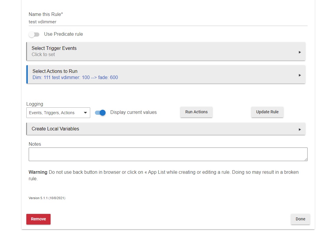

One option would be two use Rule Machine with the double-click as the trigger, or use the button controller with the double-click. Then the following (untested) rule should work:

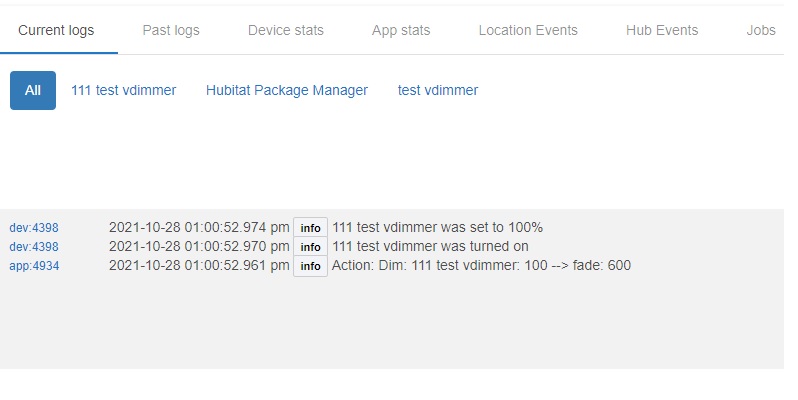

Thanks. I tried it as you suggested but it just turns the light on to 100% immediately. I even tried using the run action button in the app. Any ideas?
I can confirm that behavior using a virtual switch. @bravenel any ideas?
