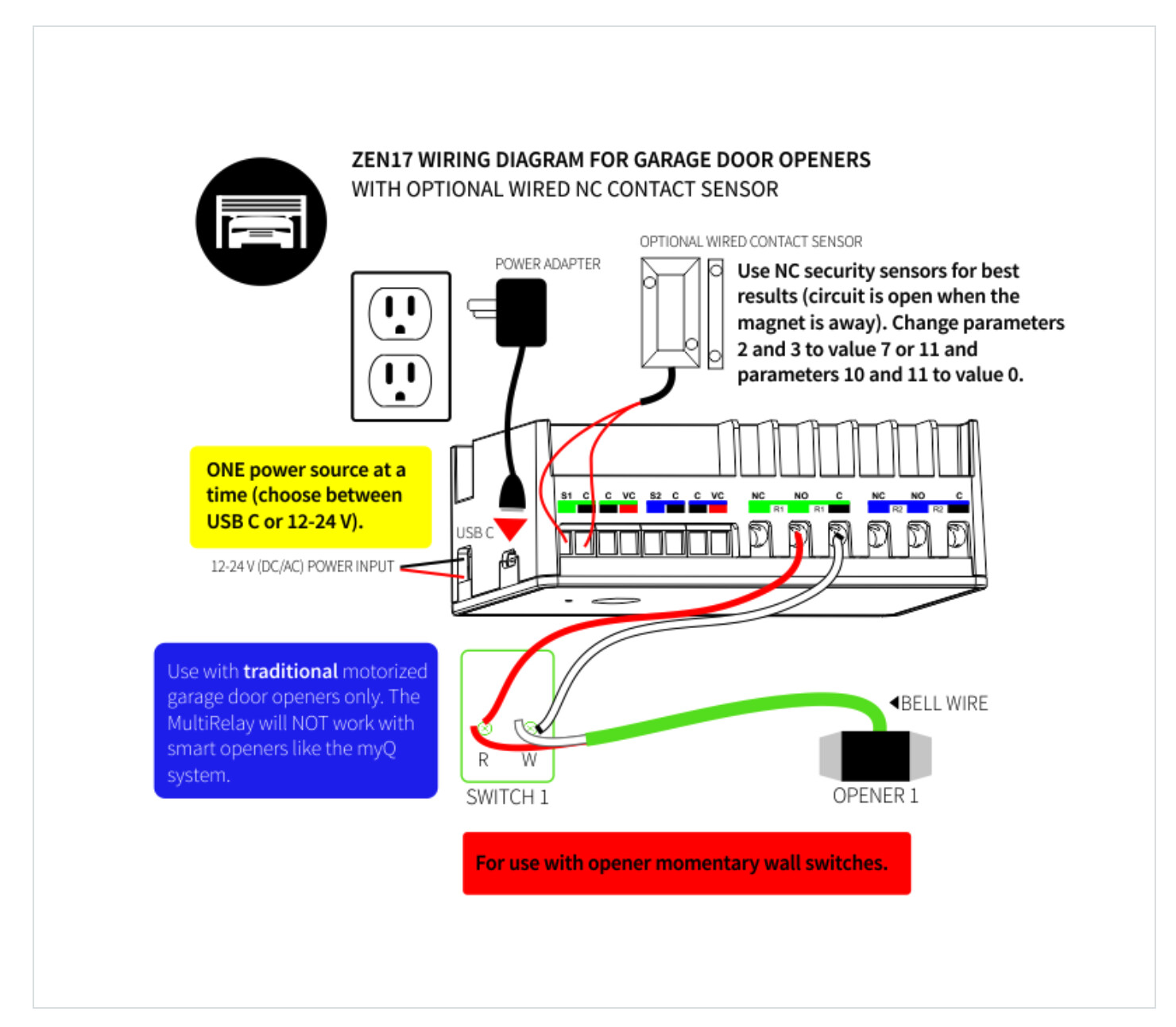

How to Use the ZEN17 Universal Relay as a Garage Door Opener - Zooz Support Center (getzooz.com)

Take it one step at a time. You have a relay on the ZEN17 wired in parallel to the wall button, correct? If you close that relay on the ZEN17 for one second and then open, does the door operate?
Yes I have R1 C/NO wired to the garage door and when I close the relay I was able to close then open the garage door.

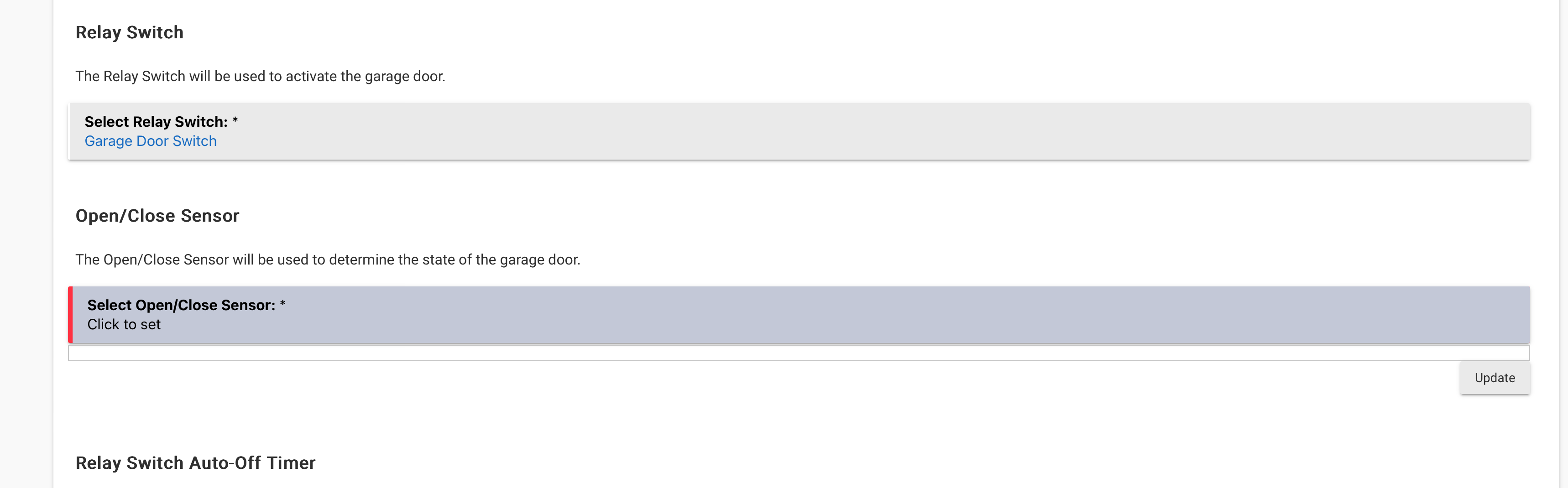

Okay I have everything installed down to step 7 in the HE setup section on Zooz.
https://www.support.getzooz.com/kb/article/1128-how-to-use-the-zen17-universal-relay-as-a-garage-door-opener-on-hubitat/
When in HE when I try to select open/close sensor I cant select the contact to us.
Would need some details about your contact sensor, the driver it has must not have the correct capabilities to show in that list. So what is the contact sensor and what driver is it using (listed as TYPE on the device page).

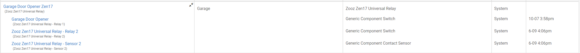

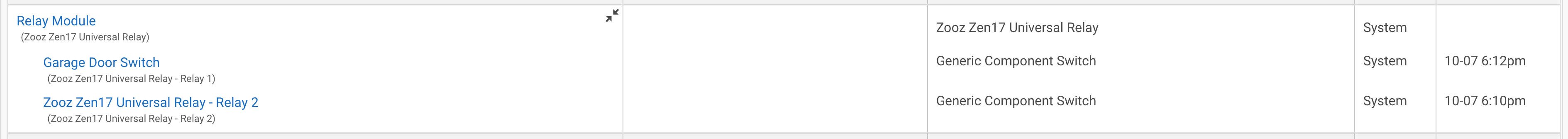

When you look at the Zen17 device in HE do you see something like this. My image has input 2 set to a contact sensor, but my point is you should see a child device as a contact sensor.
I do not see the sensor part..

You will likely need to repair the device to get the contact sensor functionality to fully kick in. but then it should show up on that list to be selected.
It did show up.... without a repair...

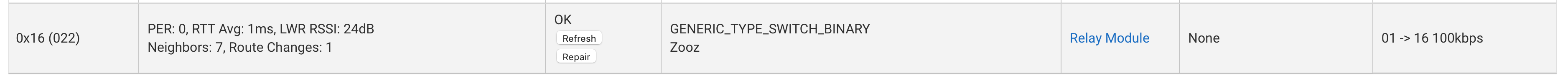

But just in case, how do I do the repair?
Here?
