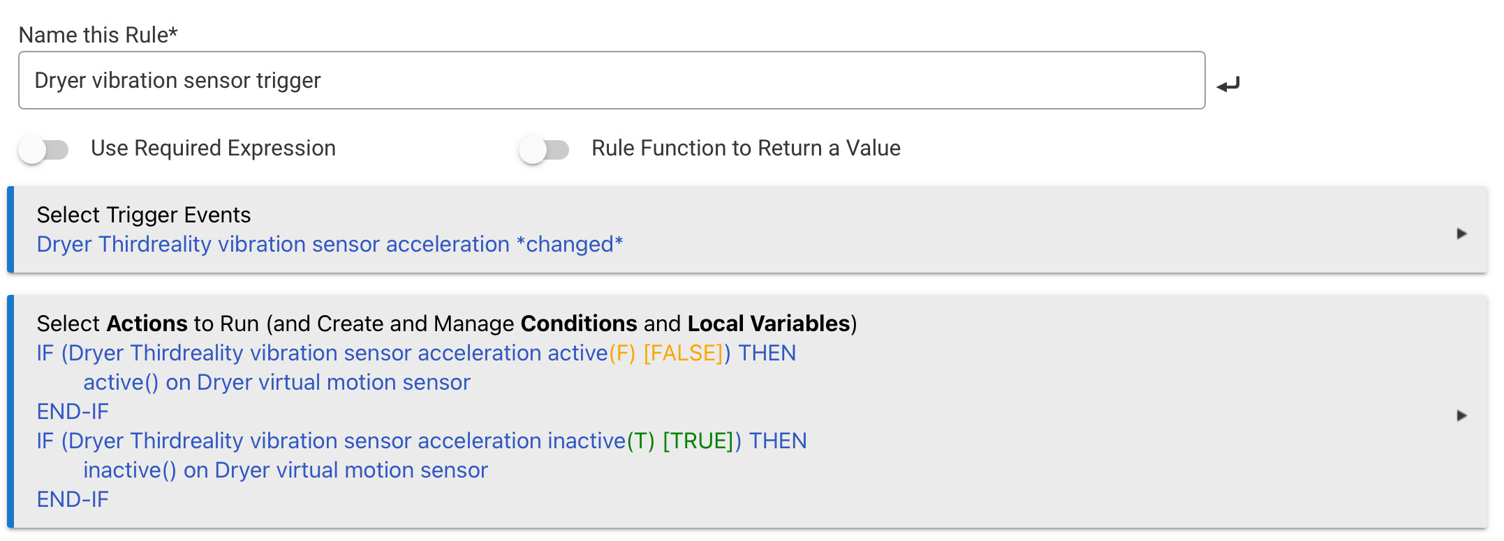

You can rig this together yourself if you use a virtual Motion Sensor, and write some rules to sync the two devices.
So create the virtual motion sensor, and then make rules so that when the vibration sensor detects vibration, it sets the virtual motion sensor active. You can have the virtual motion sensor go auto-inactive, or disable that and make another rule to update it to inactive when vibration stops. Then use the virtual motion sensor with the Zone Motion Controller app.

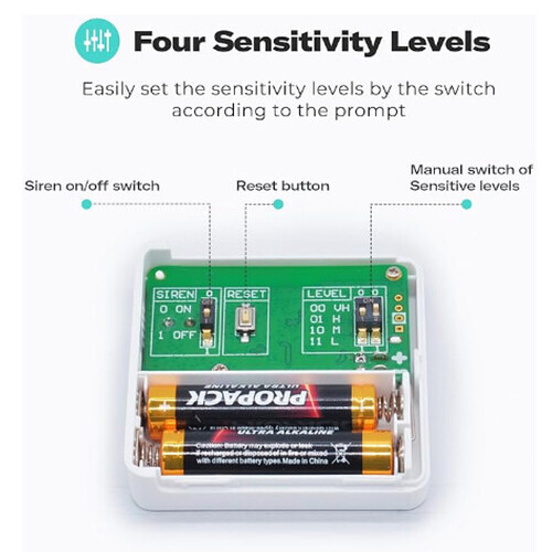

1.Buy the Thirdreality vibration sensor. I tried others, but this one actually works; THIRDREALITY Zigbee Vibration Sensor with 110dB Alarm, Zigbee Hub Required,Adjustable Sensitivity, Work with SmartThings, Home Assistant via ZHA/Z2M and Echo Devices with Built-in Zigbee hub: Amazon.com: Industrial & Scientific
2.Turn the SIREN switch off, and the LEVEL switches to 00 (max sensitivity).

4.Create a virtual motion device. This will be used by the Zone Motion Controller. Be sure to name it something meaningful since this is about to get confusing. I called mine “Dryer virtual motion sensor”.
5.You need a rule that will activate and inactivate the virtual motion device based on the status of the Thirdreality vibration sensor.
6.Create a Zone Motion Controller. Here is an example using the Dryer virtual motion sensor you created in step 4.
7.Now is a good time to test things. Tap on the Thirdreality sensor while watching the Dryer virtual motion sensor. It should go active, and then flip back to inactive. The ZMC will go active, and then stay active until the timeout you set.

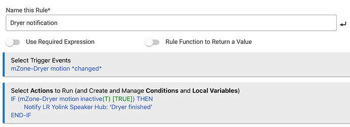

8.Setup a rule to notify you when the ZMC goes inactive. In this case, a Yolink speaker notifies me when the dryer stops (after 15 seconds).

5.Setup a rule to notify you when the ZMC goes inactive. In this case, a Yolink speaker notifies me when the dryer stops (after 15 seconds).
