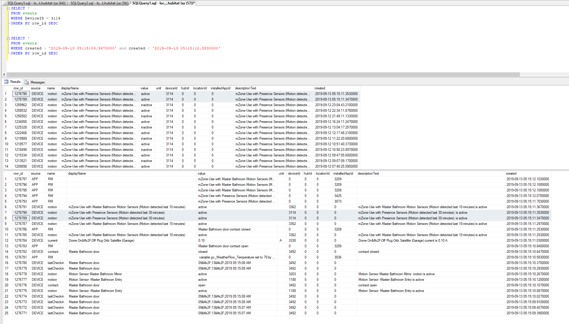

Last activity from Zone Controller
Still active all day
Remote monitoring logs from Hubitat.
1st Query shows all logs for DeviceID 3114 in reverse chronological order
2nd Query shows all logs around the time the last logs for Device ID 3114 were captured.

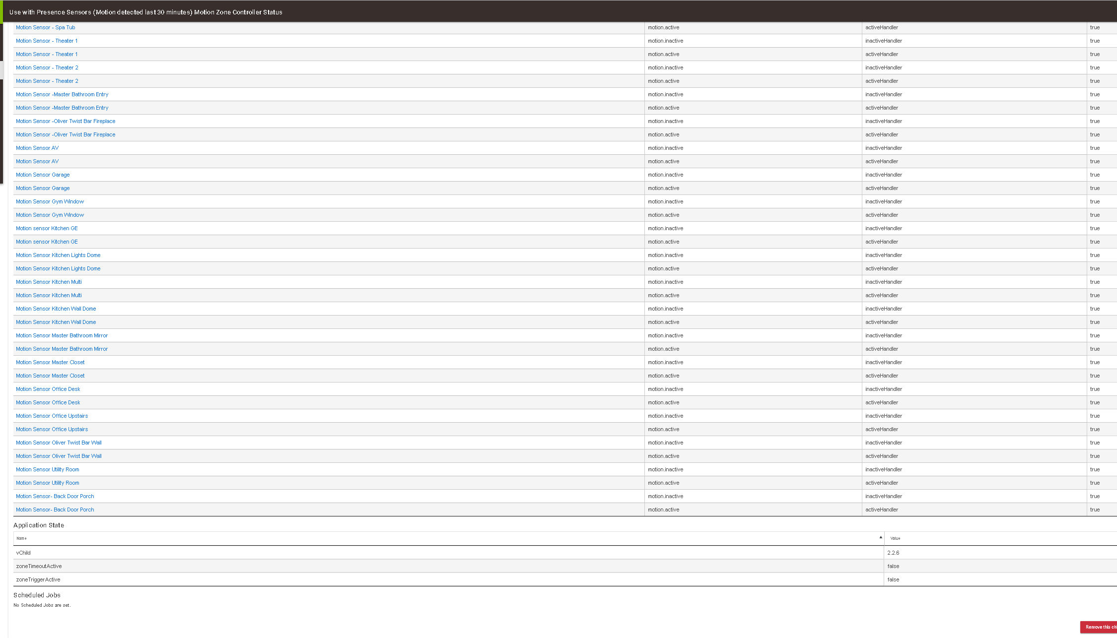

Can you show a copy of the Zone motion app that you have this sensor tied in to?
Very odd. Posted original thread at ~10pm then to bed. This morning the logs show, at 11:45pm, the Zone controller cleared. Now it appears to be triggering and clearing every 30 minutes as it should. I would really like to figure this out. Any help appreciated.

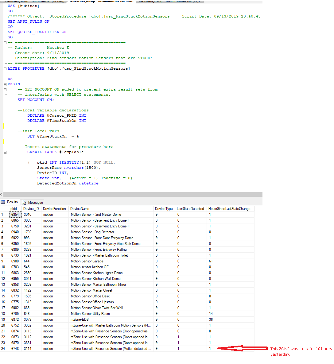

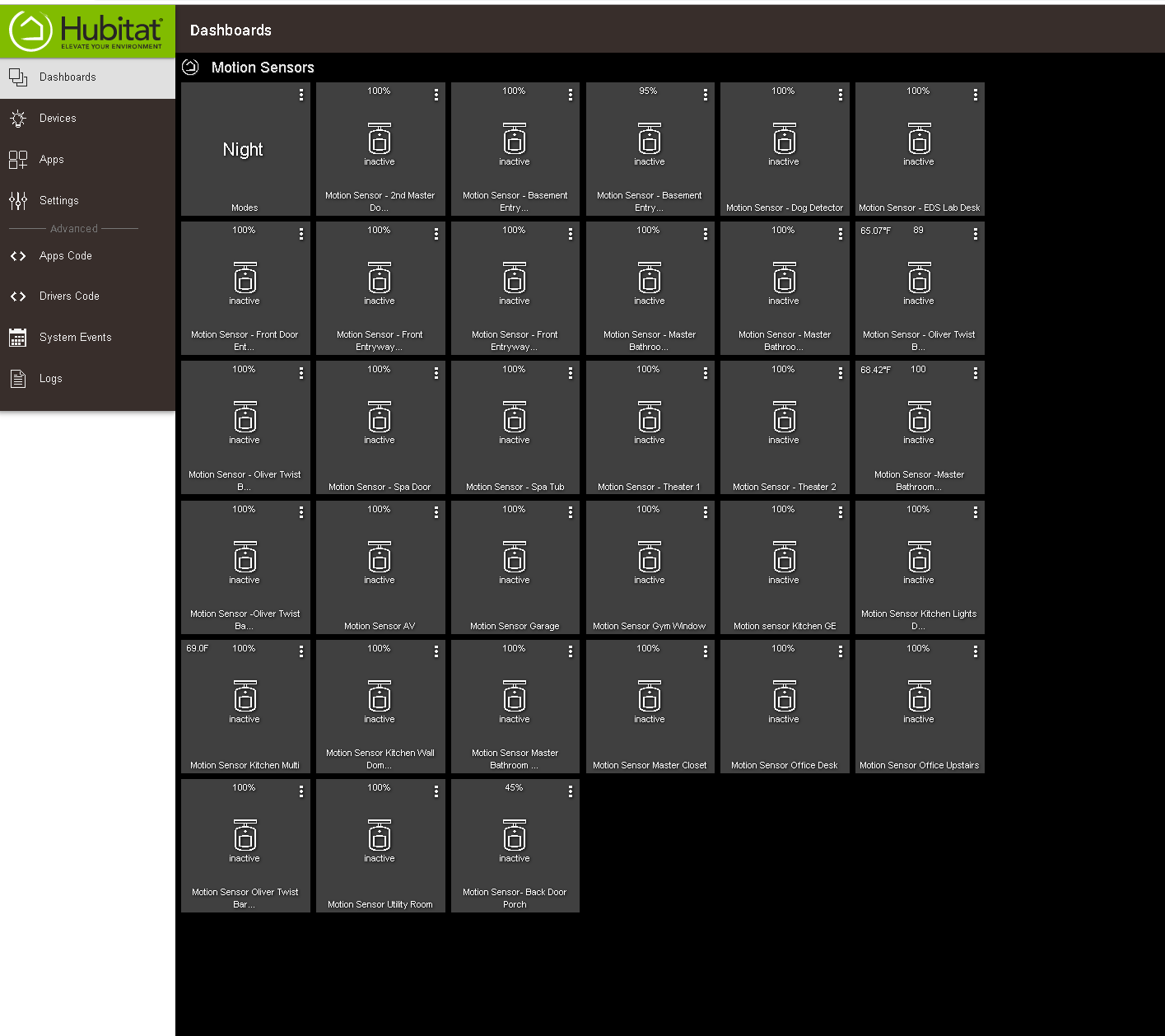

I just re-ran my stuck motion sensor report, and all are working now.

The Zone conroller is working properly.
Wrote this stored procedure this morning to analyze and report on all the motion sensors that triggered active over the 16 hours the Zone appeared "stuck" active. It wasn't stuck, there are motion sensors going active throughout the day and evening. There was never a 30 minutes in-activity period during the entire day/evening yesterday. What is setting off the motion sensors????? Different problem
I left for work at 5:15 am-ish. The wife left a bit after 7am. Dog sitter shows up at 11:45am. I return near 4:30pm from the office. All the time in between these events, sensors are being triggered, we never hit any 30 minute inactivity period.
Stored procedure and output table below.
