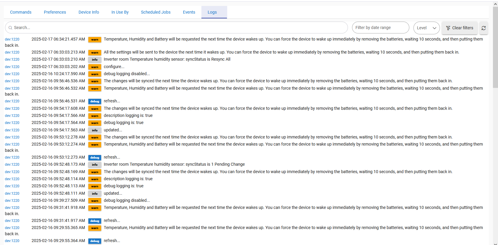

having an issue of it showing "sync status 1 Pending Change"
it suggest to "force the device to wake up immediately by removing the batteries, waiting 10 seconds," I tried that it came back with the same message
hub is C8 Platform Version 2.4.0.151
I also hit the Zigbee "rebuild network" button and same result
any suggestions that can help, Thank you

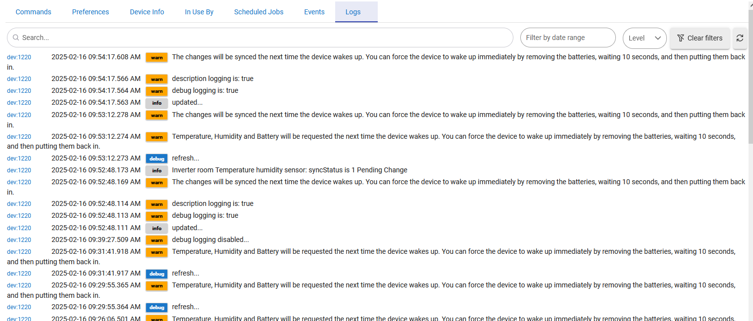

This is a sleepy Tuya device and the warnings in the live logs are correct - you can't refresh the T/H readings immediately, these will be requested next time the device wakes up.

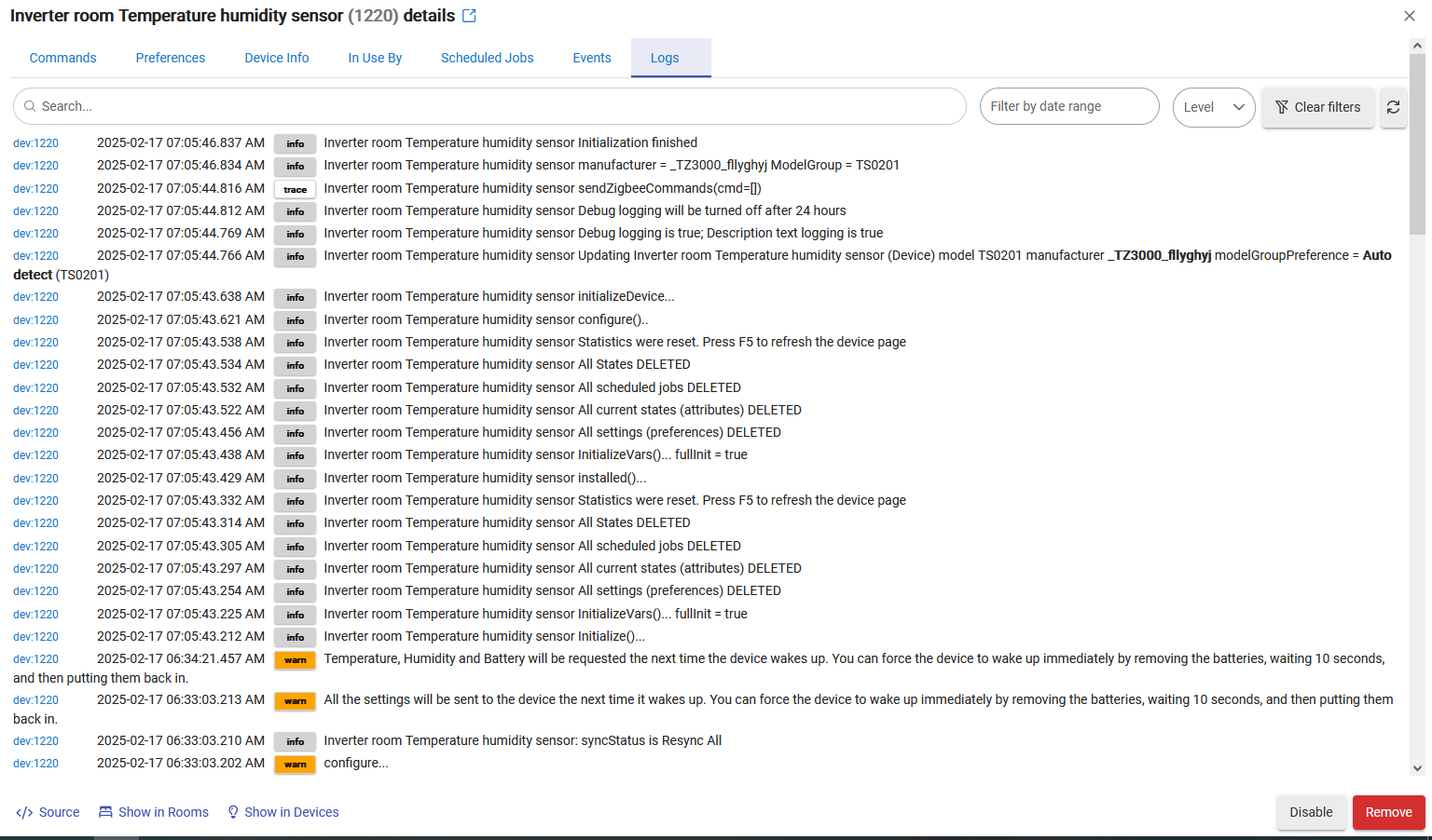

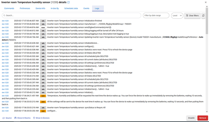

installed the driver
Enable the Debug logs.
Remove the battery for 10 seconds and insert it again.

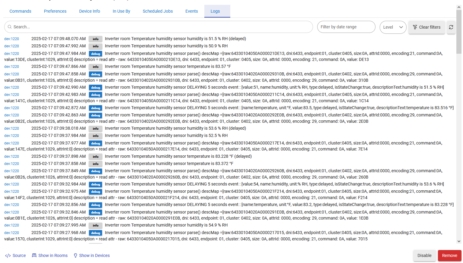

Anything in the live logs following the battery insertion?
it appears to be working
Thank you very much for your help @kkossev
