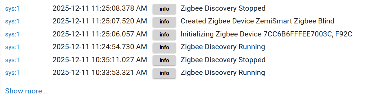

Here is a screen shot of the pairing for a Martin/Jerry RP-ZB-S01 Zigbee on/off paddle switch. It was discovered as a Zemismart blind (probably has some kind of tuya coding) Changed the driver to Generic Zigbee Switch and all works well. Figured you could add the fingerprint to the database.
Thanks, but can you post the actual fingerprint?
This can be logged to the live logs by changing the driver to "Device", then clicking the getInfo command...
