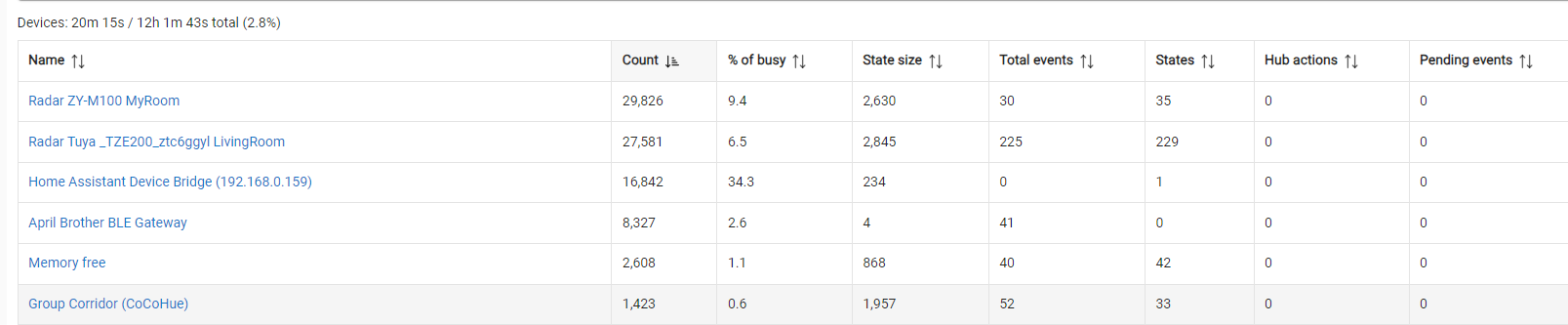

I've used that column (when sorted, ascending) to find devices that have never checked in (0 messages). It's a quick way of finding devices that may have fallen off.

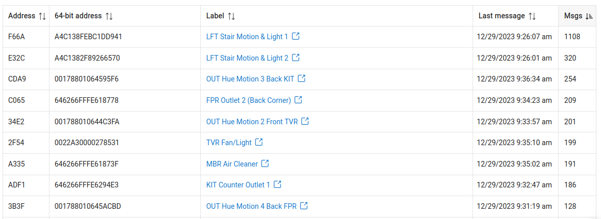

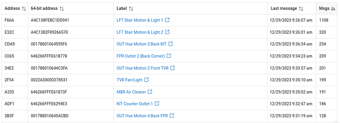

Holy Moly Larry, is that motion sensor in a bowling alley? My system has now been up about 15 hours, and my "chatty" is "only" at 958 messages...which interestingly is 3 times its closet competitor (a twin no less) in the same stairwell.

1108 now that I've trotted up and down the stairs a couple of times...
Note, as to the difference between the two Tuyas at the top, one has all logging turned off, the other has just Description Text Logging toggled on. I suspect they would be much closer if it was turned off.

These Msgs counters show all the Zigbee messages that are received by the HE hub, no matter whether they generate events or logs.
Disabling the Info (and especially the Debug) logs helps to reduce the hub load, as much less logging data is stored in the database. But the device driver is still called on every message and the Msgs counter is increased.

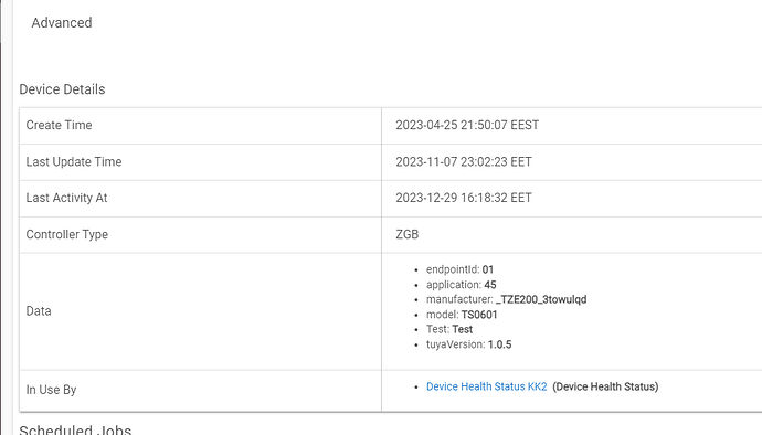

What is the Tuya model & manufacturer data of these two devices on the top ?

These are just labels printed on the box... Please copy/paste the model and the manufacturer, as shown on the HE device web page - Device Details section.
It seems fine -- I really don't think it's part of my issue.

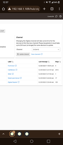

I'm going to change the Zigbee channel on my secondary hub, just to make sure it's not (somehow) the guilty party.
