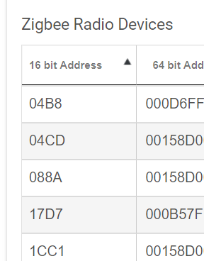

On one of my hubs, when I look at the zigbee child and route info screen, I see one entry I don't understand:
status:Active, age:64, routeRecordState:0, concentratorType:None, [Xavier Bedroom Smart Vent, 17D7] via [null, 0862]
"null" doesn't seem good... And checking my zigbee details page, I have no zigbee device with an address of 0862.... However the device listed is talking to the hub, as I see events show up in the Zigbee Logs from it.
Capture
Any thoughts?

@mike.maxwell do you have any idea what the phantom null device might be?
Do you have an Xbee or anything added to your network? Or have you ever tried to add any device (probably a repeater) that got stuck at "Initializing"? I saw "null" once with a DNI that matched that of my Xbee after I tried to add one and it got stuck at "Initializing" (XCTU still showed it as part of my network, routing to the coordinator and with the matching DNI). I could imagine something similar happening with any device that got added but stuck at "initializing." I'd wager a guess that "null" is what it shows for the device name/label when it's not in the hub database (and therefore doesn't have one) but is somehow on the network (as my Xbee was).
I also used to see raw HTML when I went to the getChildAndRouteInfo page until I reset my Zigbee radio and re-joined everything (not something I'd normally recommend). I have about 50 Zigbee devices, so well above the mid-20s where you began to see problems, but still probably far from a a large Zigbee network. This time, somehow, I got the Xbees to join properly, however. :slight_smile: (Getting those devices reset was a bit of work and I'm still not sure exactly what I did provided the solution.)
I have noticed this from time to time on my network. I'm pretty sure it is the address of a device that is no longer responding to commands at that address, which would explain why no devices in the device list have that address. For me, when I see the null device listed, it usually means that one of my peanut plugs has dropped off. I have around 100 zigbee devices and for some reason one of the peanut plugs will drop off the network every week or two and I have to rejoin it.
I don't know. But on this hub I have only ever had four repeating zigbee devices - it is brand new. And all of them show up as repeaters in the list, and all four show up in the zigbee details page too. so I have no idea what the null device would be.
Like I said, everything is working on the hub so it must not be that big of a deal. Just seems weird.
I think that happens if one rejoins at a different address, maybe after a power disruption to the device. I don’t know if it will clear without a reboot.
We had a bunch of power blinks/outages a few days ago... Could have happened then.
I’ve had my Sylvania bulbs switch addresses after a power outage, but I didn’t know about the routing table because I was on SmartThings at the time.
I had a "null" show up recently when a Zigbee device died, and I deleted it from my Devices without removing it correctly.
Turning off the Zigbee radio for 45 minutes or so and then turning it back on made the "null" go away.
