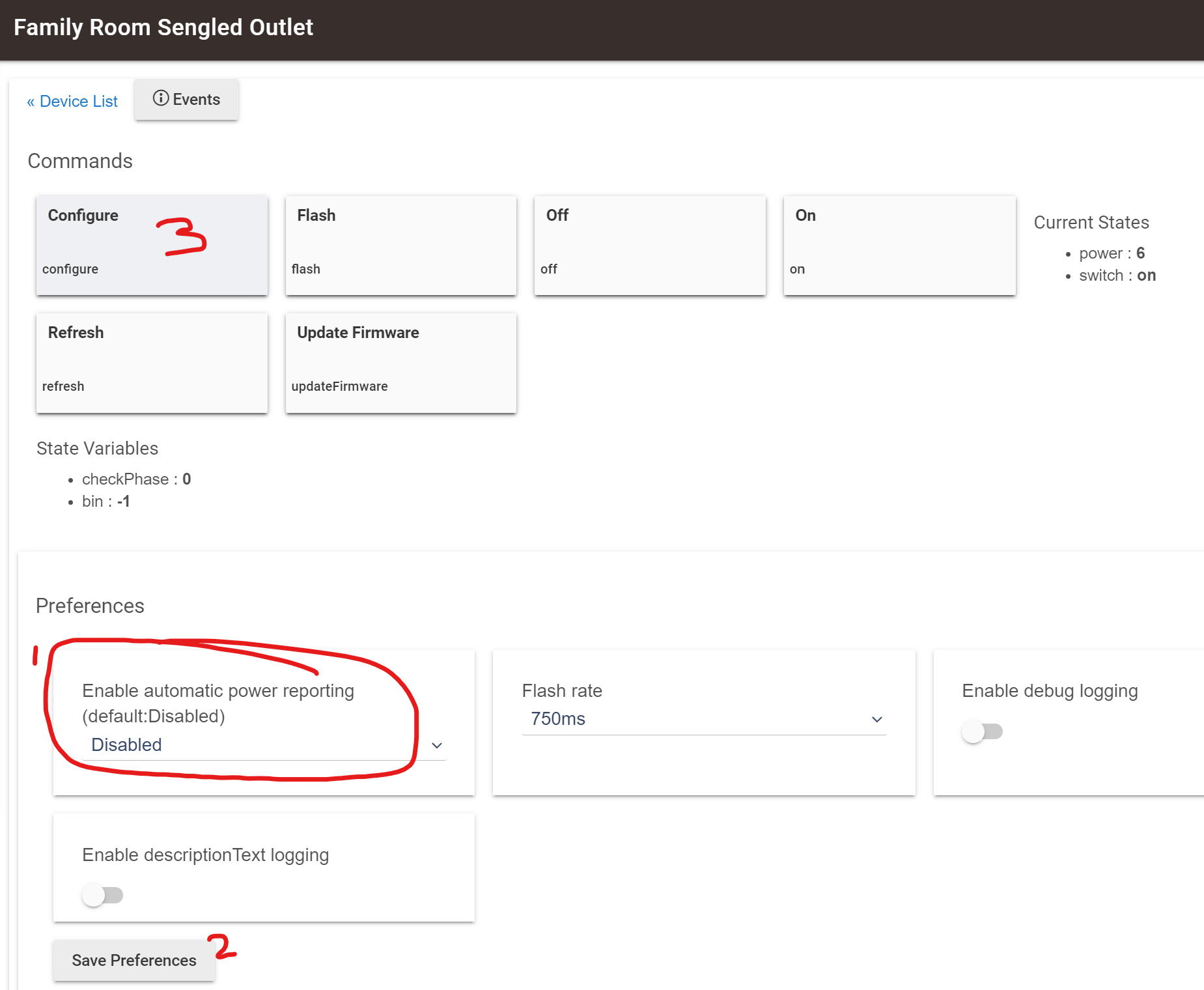

If the outlets support power/energy reporting, try disabling that feature on their device details page. Sometimes, those power/energy status updates can spam the network and cause issues.

Do you have any rules or automations that are POLLing or REFRESHing these outlets? Also, go into each of the outlet's device details page, make sure power reporting is disabled, then click SAVE. Afterwards, for good measure, click CONFIGURE.
