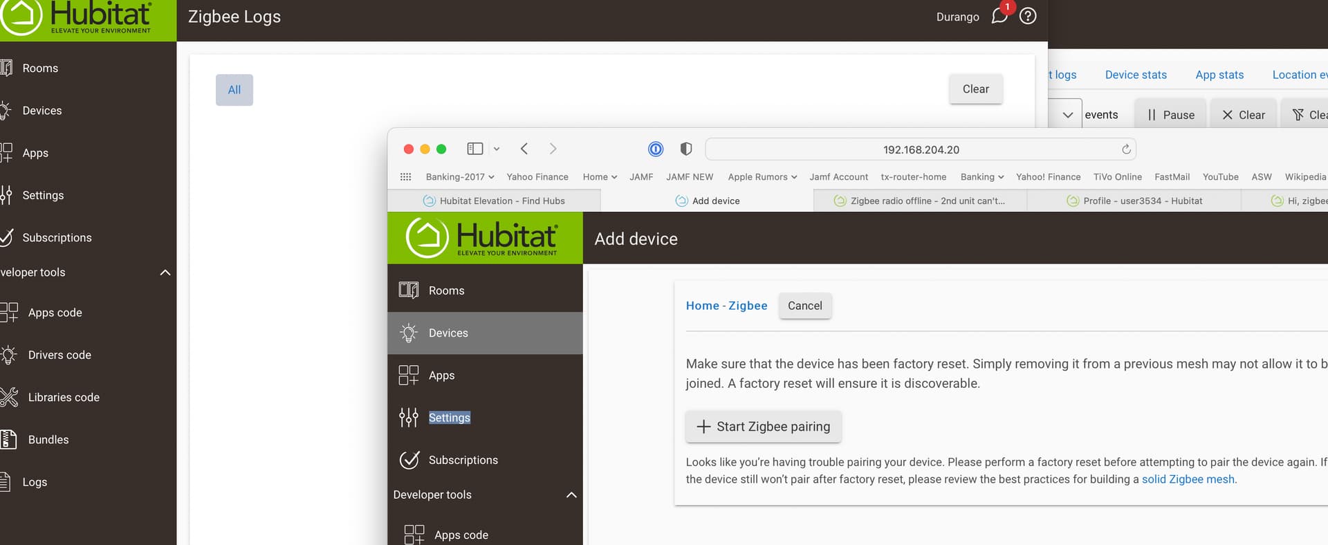

this is logs during.after
sys:12022-12-12 05:09:59.584 PMinfoZigbee Discovery Stopped
sys:12022-12-12 05:09:52.578 PMinfoZigbee Discovery Running
sys:12022-12-12 05:09:52.293 PMinfoZigbee Discovery Stopped

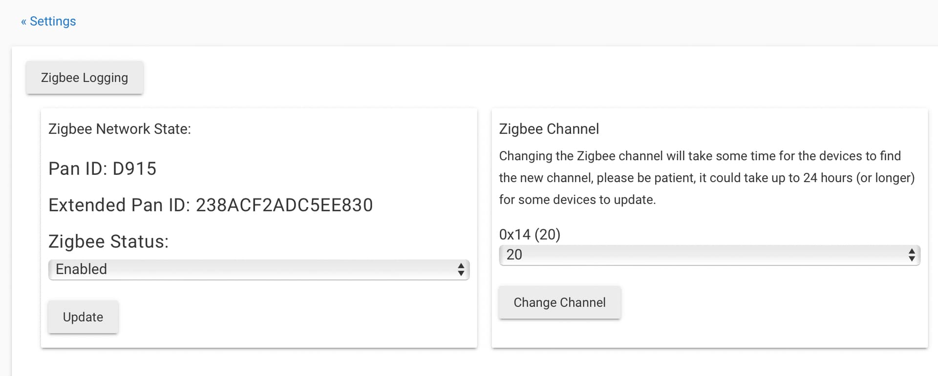

What zigbee channel is the hub on? Can you also check post a screenshot of the zigbee logs during/after discovery?
Channel 20, here is the logs open during.after
See the little box called "Zigbee Logging" in your second screenshot? That's the zigbee logs.
Can you click on that to open it? And then run zigbee discovery?
Nothing shows up, 1 window zigbee logging open, and 2nd zigbee add device, nothing shows up in logs, did it multiple times
