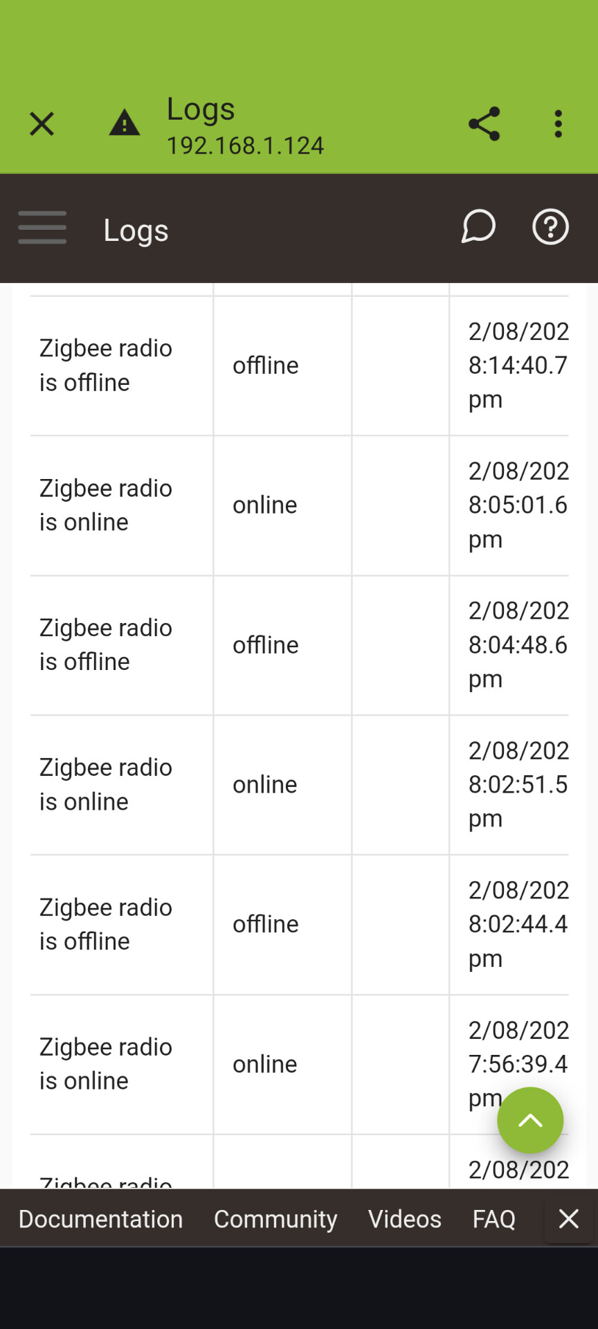

What Zigbee events do you see in Logs>Hub Events? Post a screen shot.
Nothing new, no changes.

@rdweiler in addition to what @danabw asked already, do you see unusual activity from one or more Zigbee devices in your past logs? Look for multiple consecutive events in short outbursts - that could be indicative of devices misbehaving, which could result in Zigbee radio going offline suddenly.
I honestly don't know what I'm looking for when I look at the logs. I see something for one of my zwave locks, but have no idea what it all means.
