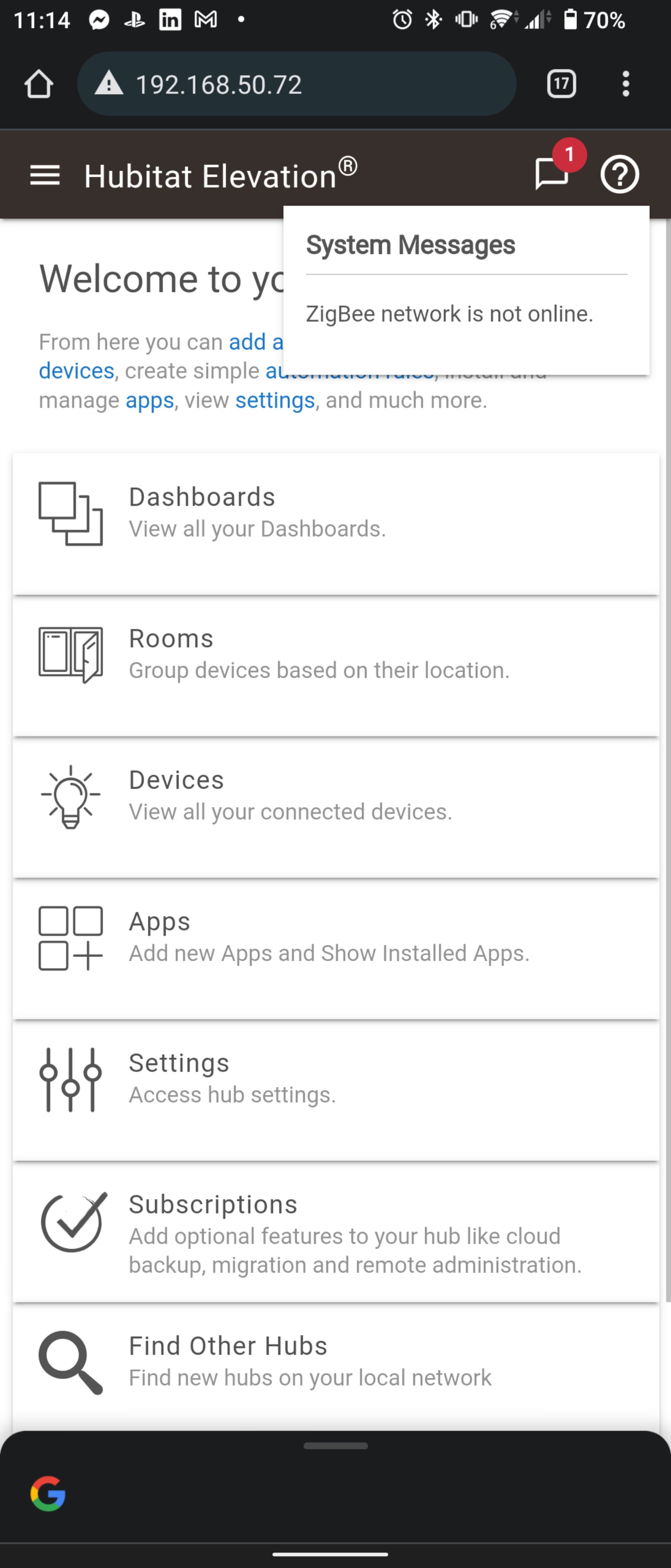

My hubitat is showing the "ZigBee network not online" error. I tried resetting and powering off the hub with no luck. After doing some research it looks like the ZigBee radio died... Is there a process to receive an rma or exchange?

When you say error, do you mean the message you showed in your original post?
Yes
