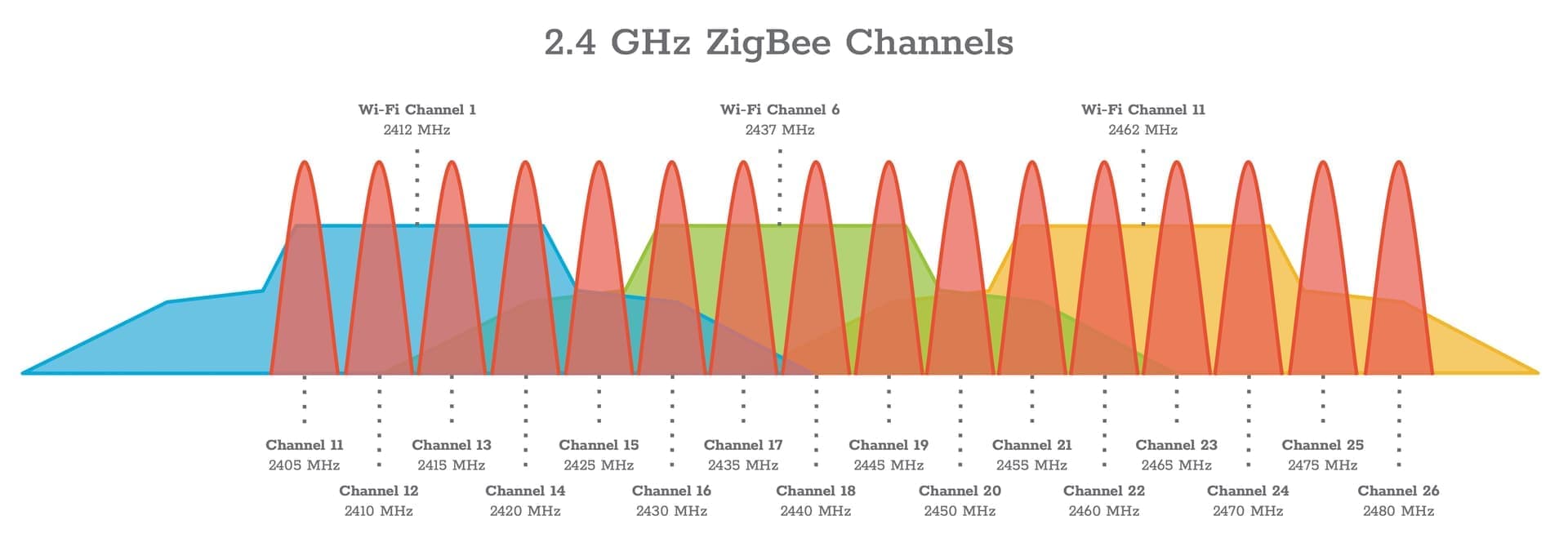

Are the two hubs on different Zigbee channels? It sounds like you're thinking they form one giant Zigbee mesh, but they actually just form two separate Zigbee networks. Keeping them on different channels (and avoiding ones that overlap with Wi-Fi or other interference that may be present in your environment) is generally best, as good as Zigbee is supposed to be about avoiding this on its own regardless.

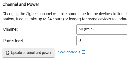

I use 8 but might try 12 or even 4

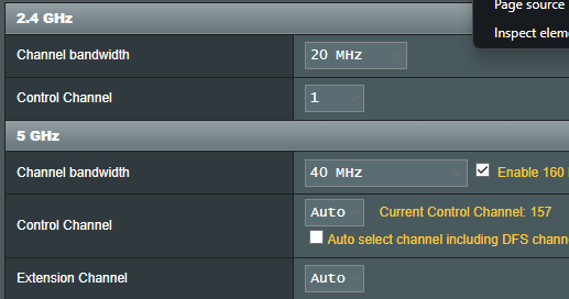

I use two hubs. One holds most of my more modern devices and the few Z-Wave devices that I have. The second is dedicated to my Iris V1 devices. They operate on different Zigbee channels. The main hub is on channel 20 and my second hub is on channel 25. I have my house WiFi set up to use channel 1, which keeps the WiFi as far as possible from the Zigbee channels.

Thank you for the information. I am not very swift on electronics, so learning, never knew about setting WiFi channels, or even that you could. My zigbee is on channel 12 with a 8 or 12 power, whatever that means. I will see if I can change my ASUS pro 12 to use Channel 1, and then set my zigbee to the highest channels, and whatever strength.
Check your wifi and zigbee channels ..
set wifi to chan 1 and use only 20 MHz wide.< zigbee to chan 20 OR 25 ONLY at power 8

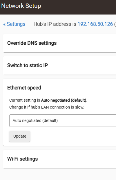

set network to auto .. if auto set to 100 then try again
Thank you, update worked. Still, no Zigbee Devices are working. My latest backup was last year, stupid yes. Disconnected Hubitat Hub #2, so back to the newest hub only. Factory reset two zigbee plugs, and then they attached to Hubitat hub. They work through app, but wonโ€™t work through Alexa app. After 24 hours, no other zigbee switches have joined. Do I have to do this all again, for every zigbee switch?

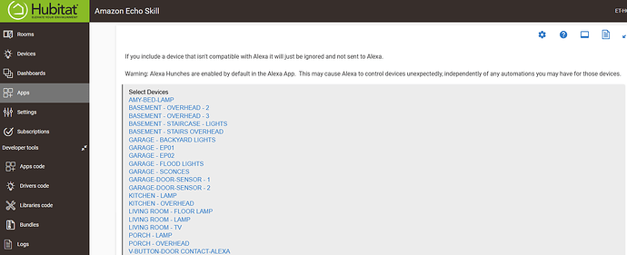

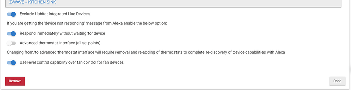

I would try .. resetting your Alexa app .. make sure the devices are in the app .. and press done
